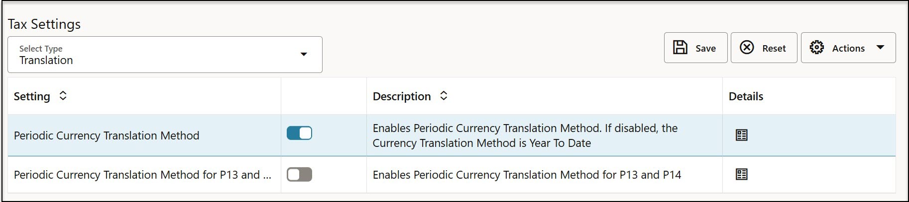

  2. Select the Translation as the setting type. Two options are available in the Translation Settings type - Periodic Currency Translation Method and Periodic Currency Translation Method for P13 and P14.
  3. Enable the Periodic Currency Translation Method by clicking on toggle button and click Save.
  4. To change Translation Settings from Periodic to Year to Date, disable the Periodic Currency Translation Method and click Save.
    Change Translation Settings from Periodic to Year to Date

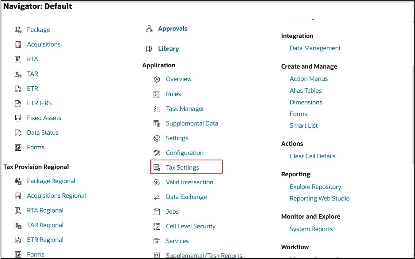

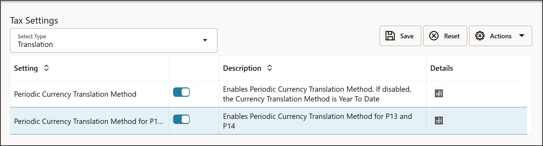

To enable translation method:
  1. Navigate to the Tax Settings card.
  2. Select Translation as the setting type.
  3. Enable Periodic Currency Translation Method for P13 and P14 by clicking on toggle button.
  4. Click Save.
    Only when you enable the Periodic Currency Translation Method Periodic Currency Translation Method for P13 and P14 can be saved, otherwise, you cannot enable it.
