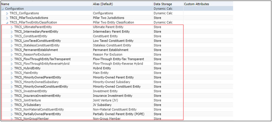

  • TRCS_PillarTwoEntityClassification and its descendants are created under Configuration dimension in the Configuration cube (see, Application Cubes and Application Dimensions)
  • All the descendants of TRCS_PillarTwoEntityClassification appears as the different classifications available in the Pillar Two Entity Classification Form as columns
  • If you want to incorporate further classifications, you have to configure a member (see also, Working with Members) under TRCS_PillarTwoEntityClassification and append a new column for that member in the form
