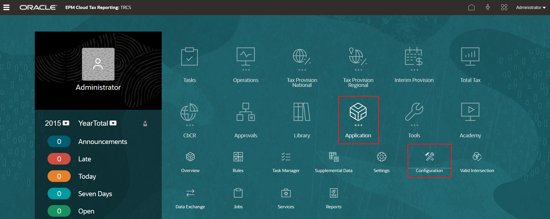

On the Tax Reporting Home page, select Application, and then select Configuration.

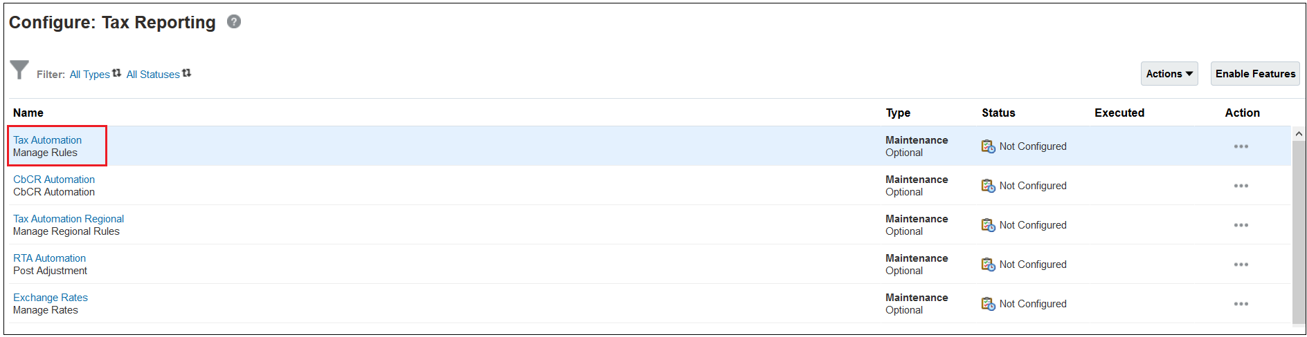

On the Configure: Tax Reporting page, select Tax Automation.

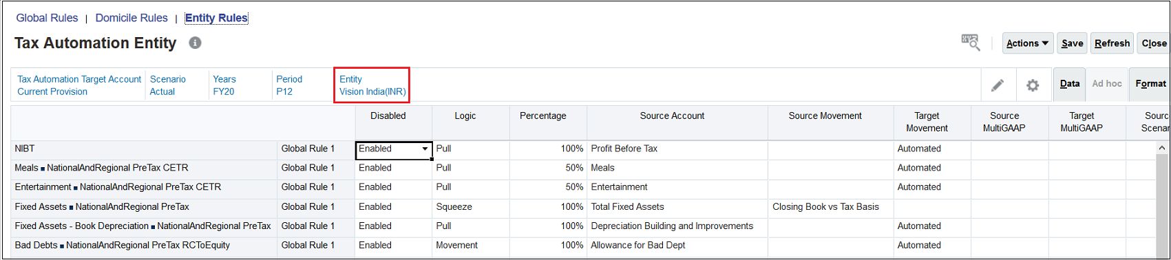

Select Entity Rules and view the rules for Vision India.

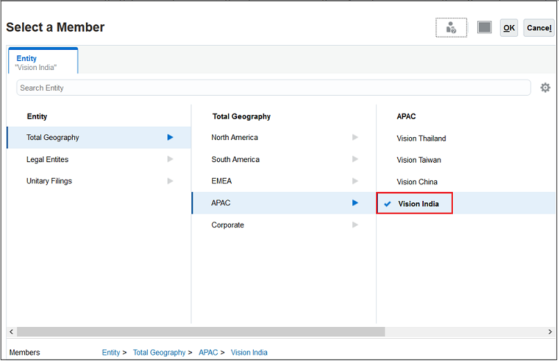

If you don’t see any rules when you enter this screen, click Entity and ensure Vision India is selected in the Select a Member dialog box.

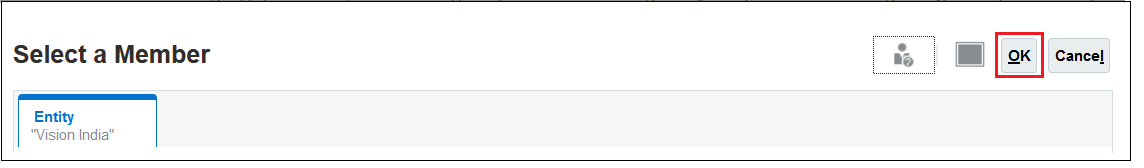

Click OK to exit from the Select a Member dialog box.

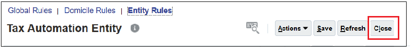

Click Close to exit from the Tax Automation Entity screen.
