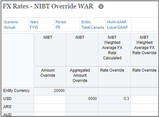

FX Rates - NIBT Override WAR
In the example below, Aggregated Amount Override column shows aggregated WAR amount at parent entity. The USD amount override data (6000) appears from the aggregated base entity(s). And, the amount used to calculate the Average Override Rate is 0.3. This rate is used to translate the NIBT account.
The same logic also applies to the Expense Override form below.

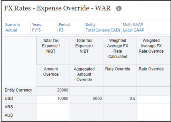

FX Rates - Expense Override – WAR
In the example below, Aggregated Amount Override column shows aggregated WAR amount at parent entity. The USD amount override data (5000) appears from the aggregated base entity(s). But, you have the option to override USD amount (10,000) at parent level and then this amount will be considered as a priority to calculate the Average Override Rate (0.5). This rate is used to translate all the expense account(s) except NIBT.
