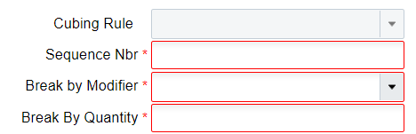

- Create a new record and enter the values for the mandatory field:
- Sequence Nbr*: Populate the sequence number.
- Break by Modifier*: Select the type of modifier:

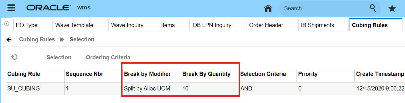

- Units (Legacy): The system does not break the OBLPN based on allocation UOM. Breaking of OBLPN's takes place based on the LPN type capacity checks and break by rules.
- Split by Alloc UOM: The system will create OBLPN for every “n” number of UOMs (Cases, Packs, Units) allocated by the wave. You can split/break the OBLPN based on the allocation UOM defined in the Allocation mode UI and define the number of UOMs in the “Break by Quantity” field.
- Break by Quality*: Enter the quantity that you want the system to break
to create the OBLPN.Note: Priority field in Cubing Rule is currently not used. Users can use the sequence number field if there are multiple cubing rule sequence created.
For example, the configuration from the figure above breaks the quantity to 10 based on the allocation UOM (Cases, Packs, Units) to create a OBLPN.

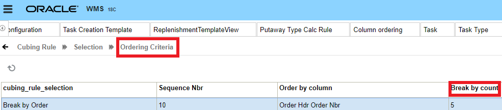

- Select this record and click on “Ordering Criteria”. This is the screen used for adding breaking logic.
- Create new breaking criteria for cartons from the drop-down in the “Order by column” field.
- Populate a number in the “Break by Count” field to configure how much it should
break by. Note: For example, the configuration from the figure above will cause the system to create a new cubed carton every 5 orders.
