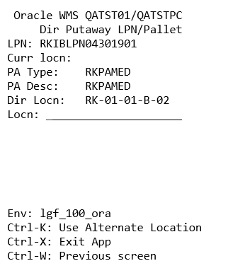

Directed Putaway – Exception
If a location directed on RF Screen is full or unavailable, a user will be able to
override the putaway location by choosing another available location in the same
zone.
- From RF Gun, in RF-Transaction ‘Directed Putaway’, Scan another available
location in the same zone.
- RF – Screen will display ‘Override Location?’

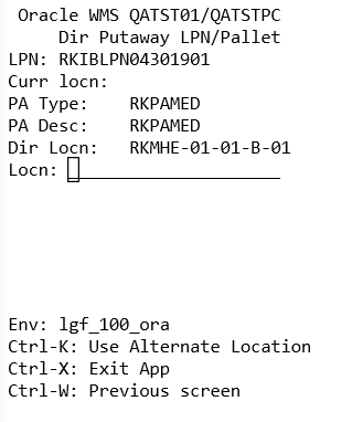

- Press Ctrl-A to accept overriding the location prompted. Note: If the location chosen already has inventory, or is reserved for another Item, the RF will advise the user that the location is unavailable. User will press CTRL-A, and scan another available location.
You can also get a list of alternate locations by entering CTRL-K.
Once you enter CTRL-K, the system will show the next location based on putaway method priority.
