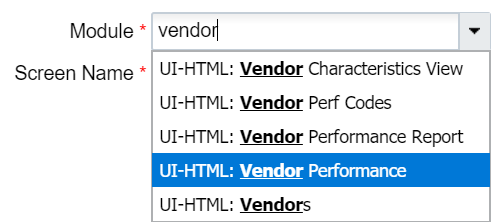

- From the “Screen Configuration” screen, search “Vendor Performance” in the
module field to add the “Vendor QC” screen (called “Vendor Performance” in
Oracle WMS Cloud):
- Add this screen to the appropriate Menu

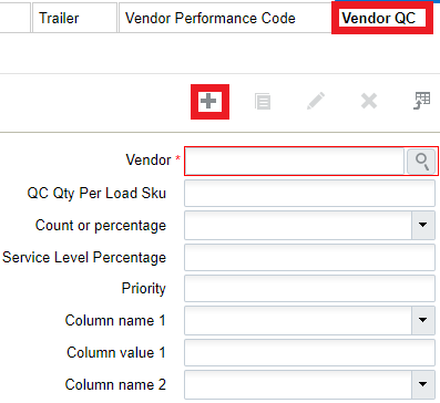

- Go to the “Vendor QC” screen.
- For each Vendor that requires QC validations, create a new record by clicking the Create button ().
- For each Vendor QC record, populate the following fields:
- Vendor: Populate the Vendor that will be used for QC. Use the magnifying glass to display a list of Vendors currently in the system.
- QC Qty Per Load SKU: Enter a value that will be checked for QC.
- Count or percentage: Enter a “U” for count and “P” for percentage.

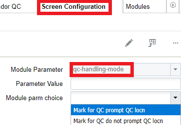

- From the ‘Screen Configuration’ screen, select an RF receiving module that will capture QC and click on Details.
- If you have a Quality Control location, set the Module Parameter
‘qc_handling_mode’ to ‘Mark for QC prompt QC locn’. If you do not have a
Quality Control location, select the parameter and click the ‘Edit’
button in order to update this parameter.
- Click “Save”.

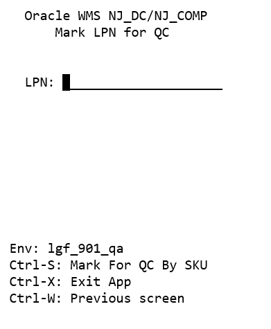

- The Mark LPN for QC transaction allows you to randomly select LPNs from a
shipment to be marked for quality control. You can use Mark LPN for QC
for cartonized shipments, and users/supervisors can select the LPNs that they
would like to designate for QC.

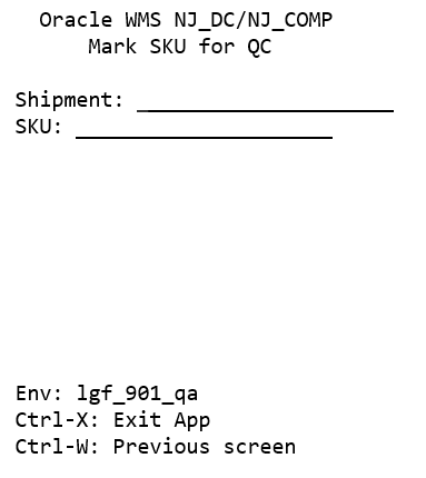

If you need to do quality control for all of the inventory for a specific
SKU, select the hot key Ctrl-S. Ctrl-S will mark the shipment detail for quality
control. Once you select Ctrl-S, the Mark SKU for QC screen
displays:
The Mark SKU for QC transaction does not support scanning an LPN which has already been received. If the LPN has already been marked for QC, the LPN is part of a shipment, and the status is Verified, the error “Scanned LPN is not valid for QC” displays.
If the LPN meets the criteria, the system displays the message “LPN% marked for QC”. The marked for qc flag on the inbound shipment detail for the corresponding LPN will be set to yes.

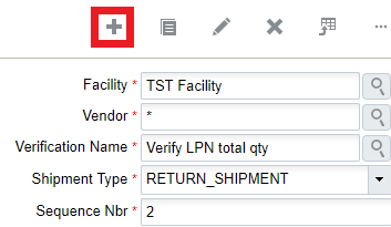

Next, go to the Verification Question Configuration UI and click Create to set up the Verification Question Configuration.
You can associate questions to the following items:
- Facility Type
- Vendor Type
- Verification Name
- Shipment Type
- Sequence Number
Questions will be displayed in the sequence set up in this screen.

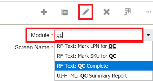

- Configure the RF module for processing the LPNs for QC.
- Go to the ‘Screen Configuration’ screen.
- Add a new RF screen with the Create button ().
- Add this new RF screen to the appropriate Menu.

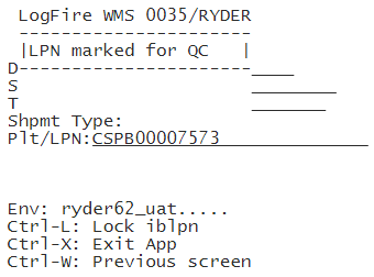

- During receiving, if the user receives an ASN from a Vendor that was flagged for
QC, the LPN will be marked for QC. This is system driven, so the user will
receive a message in the RF. Press Ctrl-A to proceed:
- The RF will prompt the user to locate this LPN to a QC location. Move this LPN
to a QC location and scan its location barcode.

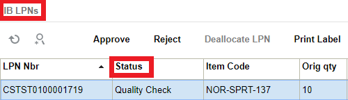

You can configure RF receiving screens to prompt or not prompt for the QC location. You can do this by configuring the screen parameter qc-handling-mode in the receiving transaction.Note: If the screen parameter on the Receiving "mode" is set to "pre-receiving", the system always pushes the received inventory to QC Area irrespective of the configuration. - At that point, the LPN will be updated to status “Quality Check” in the “IBLPN”
screen:

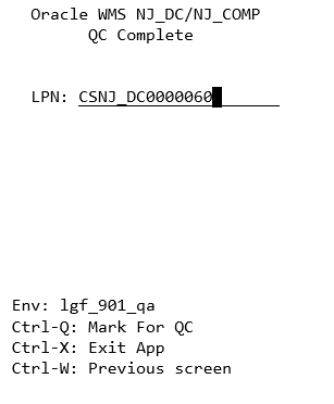

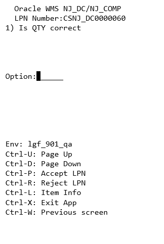

- Enter the “Process QC” RF module.
- Scan the LPN that will be processed for QC.
User can make use of the control options to approve or reject LPNs.
- Press Ctrl-P to mark the LPN to be ready for QC:
You can answer all of the questions set up in the verification question view, and also use the control options to approve or reject LPNs.
- Press Ctrl-P to approve and Ctrl-R to reject.
- If the user enters Ctrl-R to REJECT, the RF will display a confirmation message. Press Ctrl-A to proceed.
- If the user enters Ctrl-P to APPROVE, the RF will display a confirmation message. Press Ctrl-A to proceed.

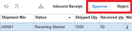

- From the Inbound Shipments screen, select the ASN with QC LPNs.
- Clicki either “Approve” or “Reject.” This will affect ALL QC LPNs in the
shipment.

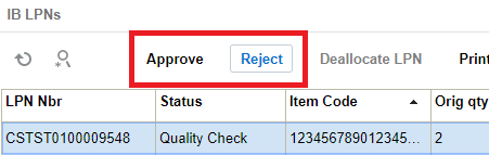

- From the IBLPN screen, select the IBLPN that is in “Quality Check” status.
- Click either “Approve” or “Reject” to process it.
