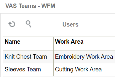

A group of users performing same activities are categorized under a team. Teams are mainly created for VAS activities. Although users can clock individually or a as team to perform VAS activities, the measure of VAS activity performed is captured only at a team level using the Daily VAS Track view.
Teams View
Teams are created using the Teams view and each team is assigned to a Work Area which corresponds to a VAS activity. The same team could be assigned to multiple Work Areas. Also, multiple teams could be assigned to a Work Area.

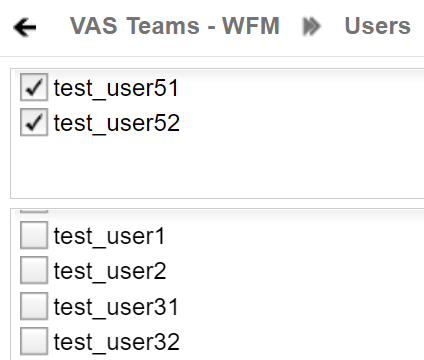

Assigning Users to a Team
To assign users to a Team, select the Team, example “Sleeves Team” and hit the Users button. This takes you to the next view with two frames that displays a list of all users configured in the application in the lower frame.
Select the users that need to be assigned to this Team. Checking the box moves the selected Team to the frame above. Hit save button.

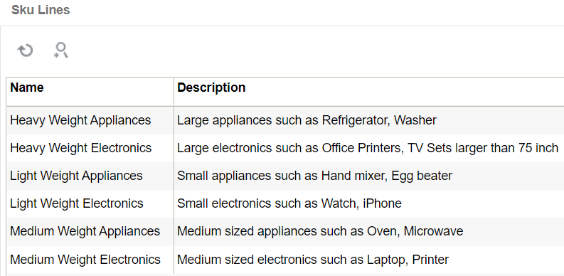

SKU Line
SKU Lines are assigned to the items in WMS in the items view. In WMS items view, the Item Line field contains the SKU Line of an item. The same SKU Lines need to be defined in WFM using the SKU Line view.

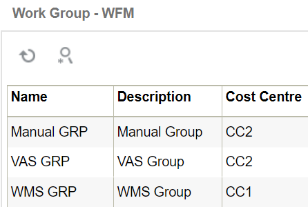

Work Group
A single work group or multiple work groups can be created within a cost center using the Work Group view.

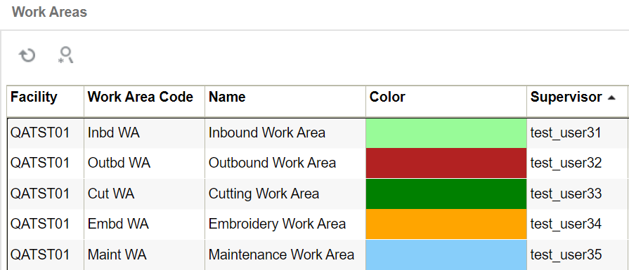

Work Area
A single work area or multiple work areas can be created within a work group using the Work Area view. A supervisor could also be assigned to each Work Area.

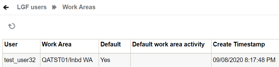

Every user that performs activities on the warehouse floor needs to be assigned to a Work Area. A user can be assigned to multiple Work Areas. Personnel that clock other users using WFM RF option should be assigned to at least one Work Area that is marked as a default. The Work Area button on Users view is used to assign a user to Work Areas.
To mark the Work Area as a default for the user, enable the Default checkbox in the create pane.

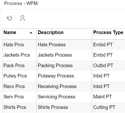

Process and Process Type
A set of related activities are grouped under a Process and multiple Processes are grouped into a Process Type. For example, the RF receiving options in WMS could be grouped under one Process. All Inbound activities such as Receiving and Putaway could be grouped under one Process Type.

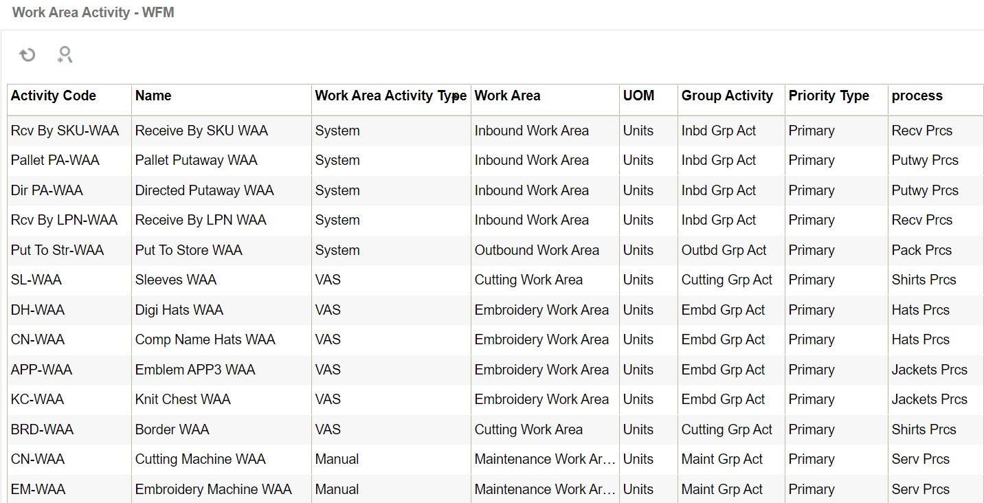

Work Area Activities
The three different activities that users could perform in a Work Area are System Activities, VAS Activities and Manual Activities. These are configured in WFM using the Work Area Activity view.
WMS Transaction

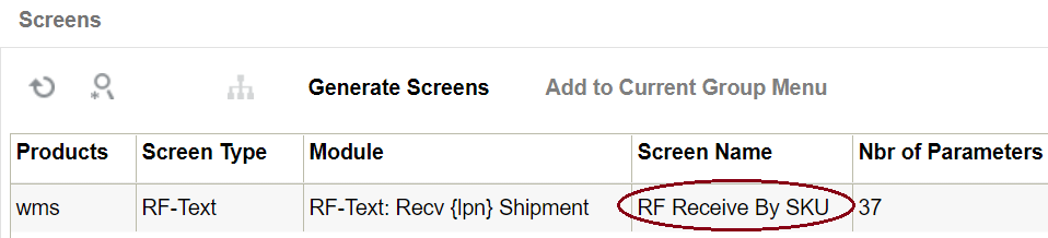

Since activities performed using WMS RF screens are considered as system activities, all such RF screens need to be associated with the System Work Area Activity in WFM. This association is made in the WMS Transaction view in WFM.
For example, assume that user needs to perform receiving by SKU. In WMS screens view, an RF screen “RF Receive by SKU” is configured.
In WFM, this screen is associated with a Work Area Activity using the WMS Transaction view. The name field in WMS Transaction view should exactly match with the screen name in WMS. If not, when data for such screens is extracted by WMS WFM Interface, it fails with the error “Unknown Transaction”

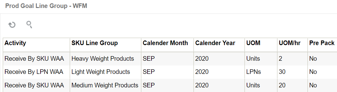

Goals for System Activities
Goals for system activities are configured using the Prod Goal Line Group view.
Every system activity needs to have atleast one goal defined for each month of a year. The same activity could have different goals defined based on the SKU Line Group. For example, a user could receive 10 units of light weight products such as microwave or laptop in an hour. However, it could take about 1 hour for the user to receive just 1 unit of a heavy weight item such as a refrigerator. Therefore goals for each activity needs to be defined based on the SKU Line Group.

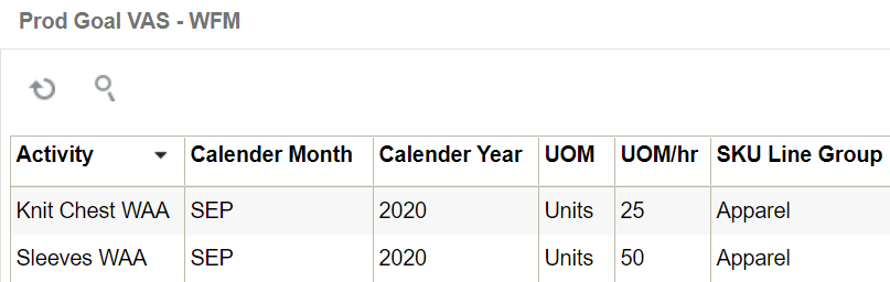

Goals for VAS Activities
Goals for VAS activities are configured using the Prod Goal Line Group view.
Similar to system activity, every VAS activity needs to have atleast one goal defined for each month of a year. The same activity could have different goals defined based on the SKU Line Group.

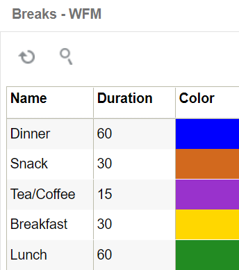

Breaks
Predetermined breaks are configured in WFM using the breaks view. A certain duration (in minutes) is allocated for each break. Users need to clock into the relevant break when they take time off from their activities for a break. This helps WFM calculate the actual time taken for a break versus the time allotted for the break.
