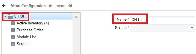

In this new window, the user will be able to separate screens into different
folders. To name a folder, select the folder and type in the name in the field to
the right.

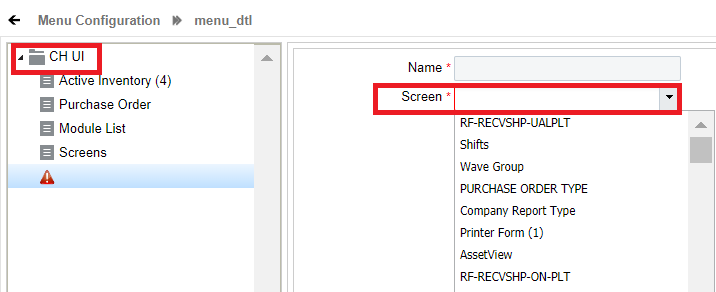

To add a screen within the folder, select the folder first, click on “Insert
Screen”, and pick the screen to add from the drop-down menu.
