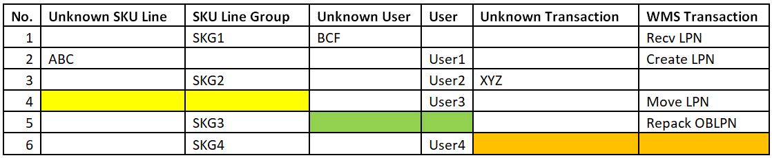

The third part of purge process focuses on invalid data. Records should either have values in Unknown fields or their counterparts. If a record does not have value in both, it is considered to be invalid data. For example, in the table below, rows 1, 2 and 3 represent valid data. Rows 4, 5 and 6 represent invalid data.
Valid and Invalid Data
Such invalid records are purged regardless of their status as long as they are older than PURGE_NUMBER_OF_DAYS from current date.
Note: It's possible such data may never land into WFM, but this step ensures clearing out any bad data in case it somehow lands in WFM)
