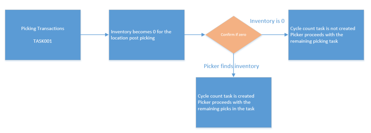

When prompt-pick-to-zero is set Yes for the picking transaction and the inventory for location becomes zero after completion of picking for that location, the system prompts the picker: “has location <location barcode> inventory reached zero? (Y/N)”. Based on the picker’s input, either ‘Y’ (Yes) or ‘N’ (No.), the system proceeds with rest of the picking task.
  • If the picker responds with ‘Yes’ (Y) confirming that the inventory for location is zero and thereby no discrepancy was noticed, and a cycle count task will not be created.
  • If the picker responds with ‘No’ (N) confirming that the inventory for location is not zero, signifies that the picker has noticed a discrepancy between the system and the floor. A cycle count task will be created for the location based on the new cycle count trigger ‘Location Picked to Zero Discrepancy.’

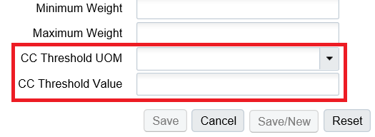

Configuring CC Threshold in Location
You need to configure the threshold value and the threshold UOM in the Location UI. The summary cycle count screen is launched during picking when the location inventory count goes blow the threshold quantity defined at the location level. By default, the field threshold quantity is set to 0.
You can also configure CC Threshold Value, CC Threshold UOM via location interface file (XML/Excel/PSV).
Note: The CC Threshold UOM for active locations can be set as units alone. The CC Threshold Value field supports decimals as well. However, when the CC Threshold UOM is set to LPNs, you are required to provide a whole number in the CC Threshold Value field when saving the location.

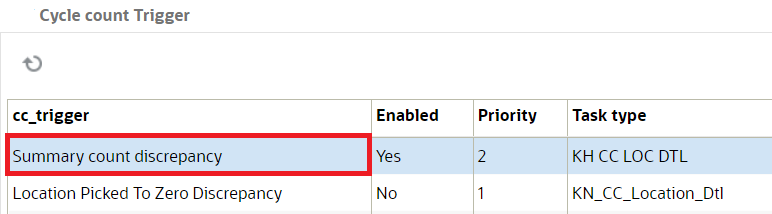

  1. Go to Cycle Count Trigger > enable ‘Summary count discrepancy’ and populate with an appropriate CC task type. Note: The parameter will be disabled by default.
    CC Trigger
  2. You can configure the Summary Count discrepancy CC trigger with either CC-LOCATION or CC-LOCATION-DTL task type. Click Save.

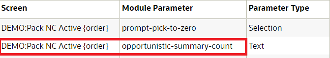

  3. Go to you picking module > screen parameter > configure opportunistic -summary-count parameter with a valid screen name of the summary cycle count module.
    Opp Summary Count
    1. When you set the parameter 'Blank', Opportunistic summary count functionality will be disabled for the associated Picking transaction.
    2. When the parameter is configured with a valid summary cycle count screen name, Opportunistic Summary Count will be enabled for the picking transaction and when inventory in a location goes below threshold value configured post picking, the summary count screen will be launched.
