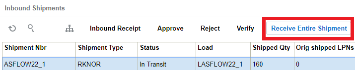

- Go to the “Inbound Shipments” screen, select the ASN and click “Receive Entire
Shipment”.Note: Ensure the ASN is cartonized prior to receiving the entire ASN.
- Oracle WMS Cloud will display a confirmation message. Click “Yes”.
- The ASN will be received based on the IB LPNs that are associated with the ASN.
