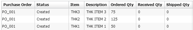

Consider Purchase Order “PO_001”, which has three items:
Purchase Order Items
For each scenario, the PO records (received and shipped quantities) will update accordingly:

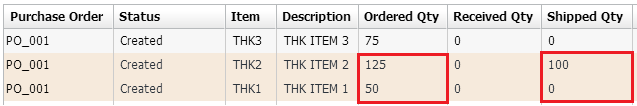

Case 1: User creates a new ASN, “ASN_001”, for items THK1 (25 units) and THK2 (100 units).
Received and Shipped Quantities
Result: The PO’s “Ordered Qty” and “Shipped Qty” fields are updated.
Ordered and Shipped Quantities
