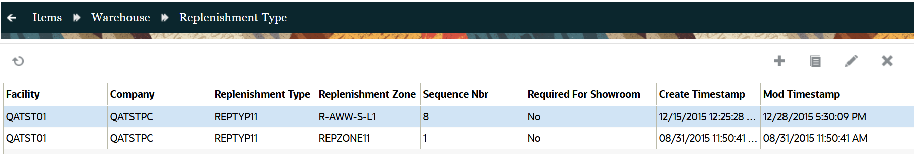

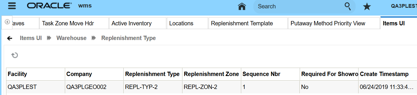

Replenishment Type to Replenishment Zone
As the system searches the Replenishment Type for the item. You need to establish an association between the replenishment type and the replenishment zone by defining the sequence number.
This configuration is helpful as items classified with similar replenishment type will be
            assigned to similar locations which do not have permanent items assigned.
