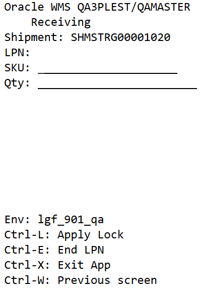

- On the next screen, the system prompts for SKU and Qty. The LPN field remains

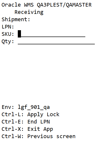

                    blank. - When “lpn-prompt” is configured as Auto Generate and “mode” is
                        configured as Blind ASN Receiving, the system brings you to this
                        screen when it invokes the RF Shipment/RF Load option. The first screen is
                        not displayed. Note the blank Shipment field in the screenshot below:

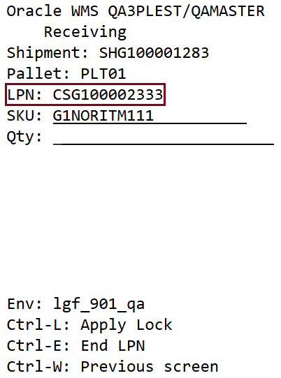

- Once you scan the first SKU, the system generates an LPN Number based on the
                BLIND_LPN_NBR sequence counter. The auto generated LPN Nbr is displayed on the
                screen until the LPN is ended. If the screen parameter “mode” is set to
                    by-sku-qty, you are prompted for qty. If “mode” is set to
                    by-sku-scan, you are prompted for the next SKU to be scanned.
