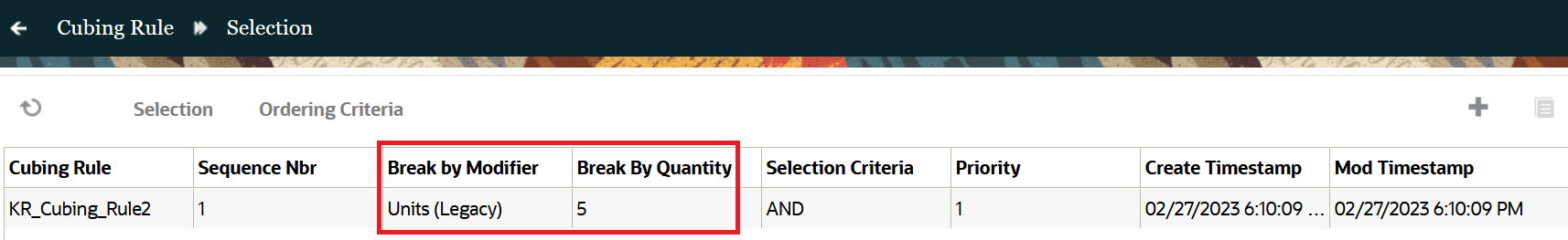

You can use Cubing Rules UI to configure the rules for breaking cubed containers:
- Go to the “Cubing Rule” screen.
- Create a new record and add a description.
- Select this record and click the Details button. This will prompt you to a new screen.
- Create a new record and enter the values for the mandatory field:
- Sequence Nbr*: Populate the sequence number.
- Break by Modifier*: Select the type of modifier:
- Units (Legacy): The system does not break the OBLPN based on allocation UOM. Breaking of OBLPN's takes place based on the LPN type capacity checks and break by rules.
- Split by Alloc UOM: The system will create OBLPN for every “n” number of UOMs (Cases, Packs, Units) allocated by the wave. You can split/break the OBLPN based on the allocation UOM defined in the Allocation mode UI and define the number of UOMs in the “Break by Quantity” field.
- Break by Quality*: Enter the quantity that you want the system to break
to create the OBLPN.Note: For example, the configuration from the figure above breaks the quantity to 10 based on the allocation UOM (Cases, Packs, Units) to create a OBLPN.
- Select this record and click on “Ordering Criteria”. This is the screen used for adding breaking logic.
- Create new breaking criteria for cartons from the drop-down in the “Order by column” field.
- Populate a number in the “Break by Count” field to configure how much it should
break by. Note: For example, the configuration from the figure above will cause the system to create a new cubed carton every 5 orders.
