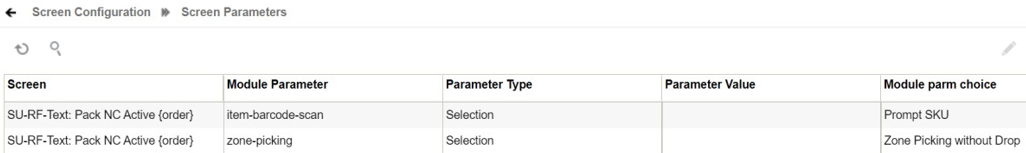

RF Pack NC Active {order} is configured with the Zone Picking parameter, and “Zone Picking without Drop” parameter choice. |

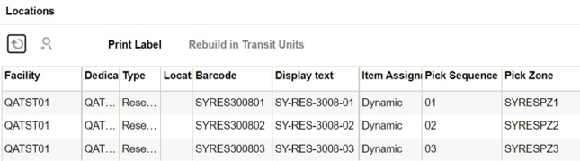

- First, you will create three Reserve locations. Each reserve location belongs to a different pick Zone:

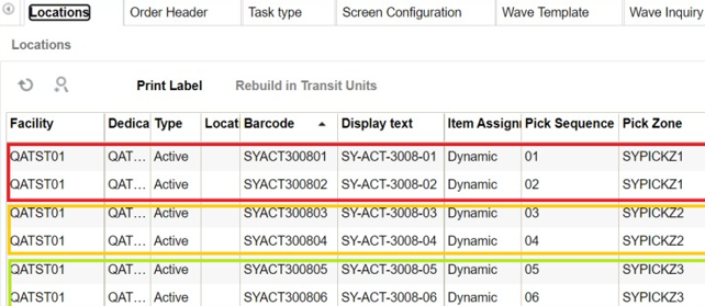

- Then, create six Active Locations:
There are three Pick Zones. In each Pick Zone there are two Locations:

For RF Pack NC Active, we have configured the zone-picking module parameter with the Zone Picking without Drop parameter choice.
