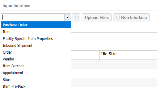

Step 2: Uploading the Interface file into Oracle WMS Cloud
- Go to the “Input Interface” screen.
- Use the drop-down to select the appropriate interface to process:
- Click on “Upload Files” and navigate to the file you wish to upload.
- When the screen displays the file, click “Run Interface”.
- The system will return a message dialog that the file has been successfully processed.
