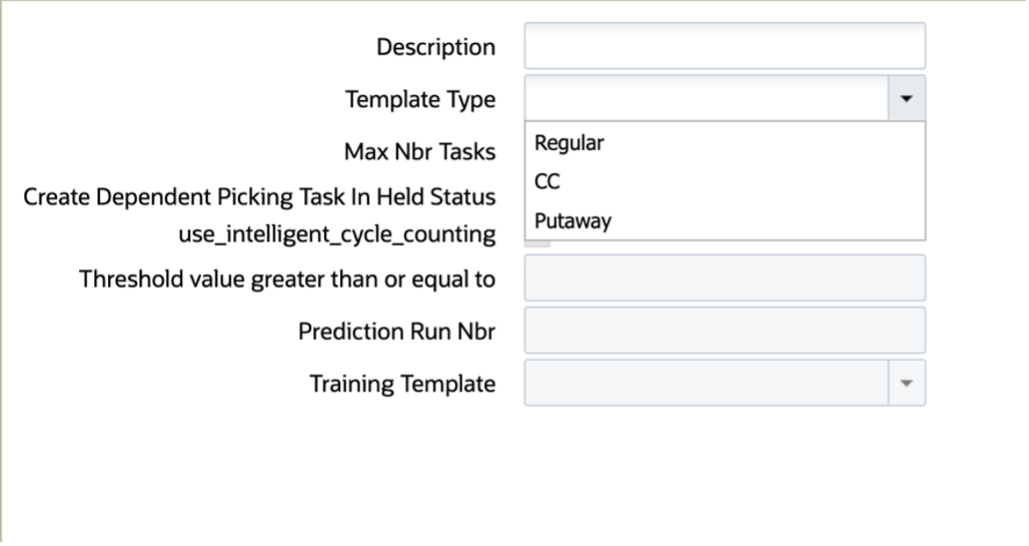

  • Navigate to Task Creation Template and select Putaway as the template type.
  • Set up task settings for PUTAWAY_CART by configuring Ordering Criteria and Zone Movement Rules.
Task Creation Template: Putaway
The Putaway Task Creation Template helps generate tasks for putaway carts, improving task prioritization and organization.
To Define Ordering Criteria:
  1. Navigate to Task Creation Template > Putaway.
  2. Select Order and click Ordering Criteria.
  3. Use Sort By and Order By columns to set task sequencing.
