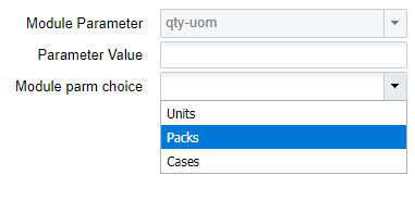

  1. Go to the “Screen Configurations” screen.
  2. Select the RF Recv [lpn] Load and click on Details (). This will display all the parameters for this RF module.
  3. Select the parameter “qty-uom” click Edit ().
  4. In the “Module parm choice” drop-down menu, select the desired UOM.

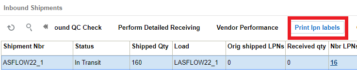

Oracle WMS Cloud also allows ‘smart receiving’, which is when LPNs are defined in the ASN prior to receipt:
  1. Go to the “Inbound Shipments” screen.
  2. Select the ASN and click on “Print LPN Labels”. This will print all the cartonized LPNs in the ASN.
    Printing cartonized labels from the ASN
  3. Enter the RF module for receiving.
  4. Scan the LPN; the system will recognize the LPN’s contents and ask the user to confirm its contents. Press Ctrl-A to proceed.

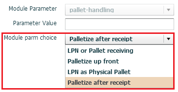

Configuration for Palletization during Receipt
For receiving flows with palletization, the receiving RF module must be configured appropriately. There are four types of palletization during receipt:
  • LPN or Pallet level receiving
  • Palletize up front (before scanning LPN)
  • Palletize at end (after scanning LPN)
  • Receive LPN as physical pallet (the LPN is treated as a pallet in the system)
To Configure on the UI
  1. Go to the “Screen Configuration” screen.
  2. Select the receiving RF module (rf.inbound.cwrfrecvlpnshpmt) click on Details ().
  3. This will open a window with all the RF module’s parameters. Select parameter pallet-handling and click Edit ().
  4. Click on the “Module parm choice” drop-down menu and select the appropriate palletization mode.
    Module parm choice
