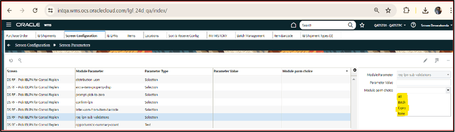

Additionally, the screen parameter, req-lpn-sub-validations, you can decide whether to enforce validation based on batch numbers and expiry dates during substitution. This flexibility ensures that items requiring special handling, such as those with expiry dates, are correctly managed.
The req-lpn-sub-validations parameter offers four options, which allow you to define the level of validation required during the substitution process:
- All: Both batch number and expiry date are validated during substitution.
- Batch: Only the batch number is validated.
- Expiry: Only the expiry date is validated.
- None: No validations are enforced during substitution.
NOTE: By default, this parameter is set to <Blank> for all existing screens. However, you can adjust it based on specific requirements to ensure smooth and accurate substitution during the RF Pick IBLPN process.
Substitution during the RF IBLPN Pick for Consol Replenishment process is only possible when the confirm-lpn screen parameter is set to Yes. This setting ensures that the system confirms the LPN being processed, providing a safeguard against invalid substitutions.
