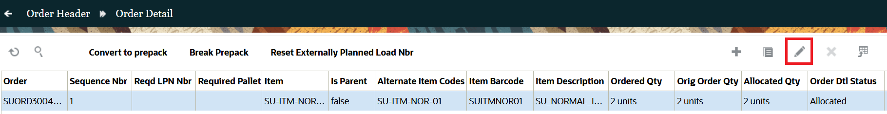

  4. In the Order Detail screen, select an order detail record to update ordered quantity and click Edit action button.
    Edit icon
  5. Update the Ordered Quantity based on your requirement.
  6. Click Save.

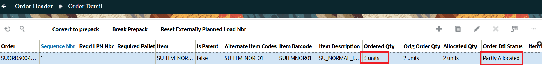

    The system updates the Order Detail status based on the updated Ordered Quantity as shown in the figure below:
    Post update Orderdtl Status

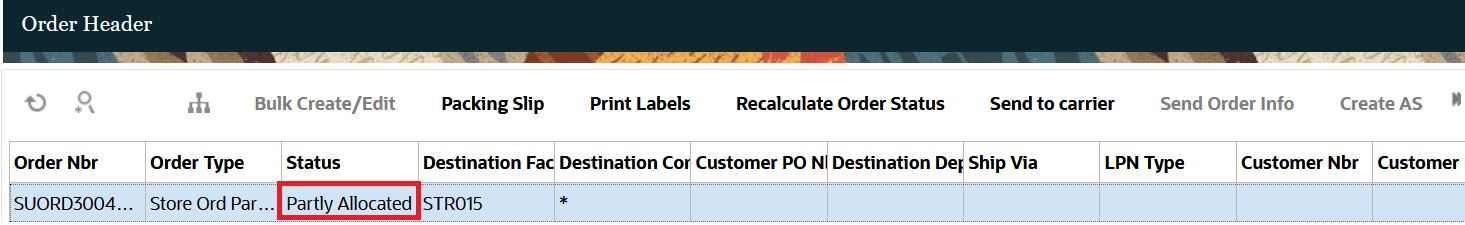

    And the Order Header screen displays the updated order status based on the order detail status.
    Post update Order status

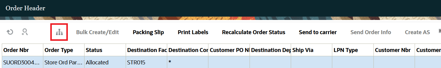

  3. Click Details action button to navigate to the Order Detail screen.

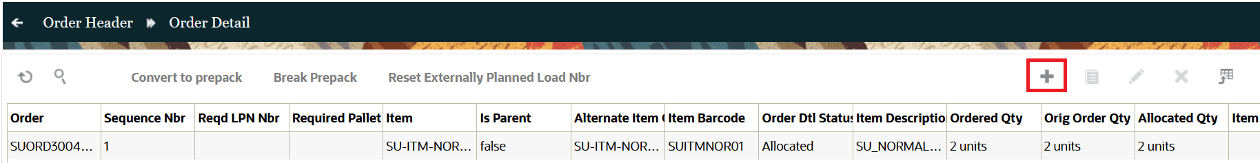

    • To add a new order line:
      1. Click Create action button.
        Adding Order line
      2. On the create pane, based on your requirement, add details and click Save.

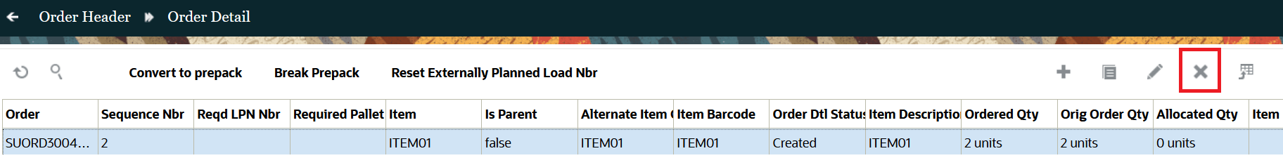

    • To delete an order line:
      1. Select the order line to delete and click Delete action button.
        Delete Orderl ine
        Note: You can delete the order detail only if the if the order detail is unallocated.
      2. Select the “Reason Code” in the Delete pop-up and click Submit.
