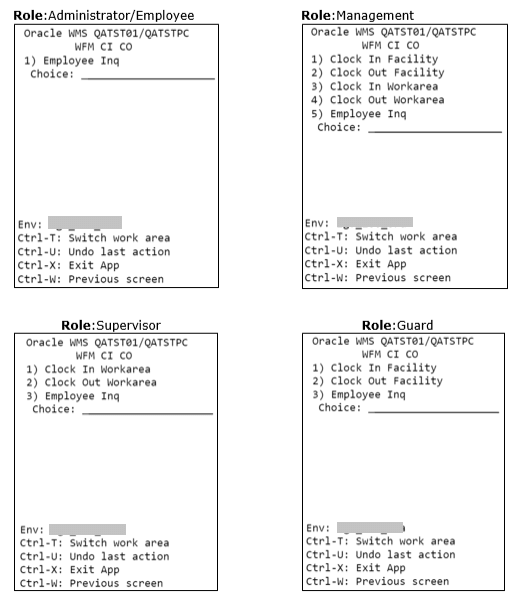

In general, this RF screen provides options for clocking users in facility and work area and also inquire about users. Depending on the role of the user that has logged into RF handheld device, the options presented on selecting this RF screen varies as shown in pictures below:
RF Roles
To summarize, only a user with Management role has access to all the options on this screen. A user with Guard role can only clock users at a facility level. A user with supervisor role can only clock users at a work area level. A user with Administrator or Employee role do not have the option to clock users either at the facility or the work area level. All users (regardless of role) have the option of inquiring about other users using the option Employee Inq.

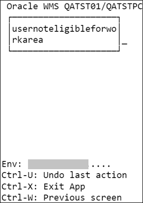

Also, to clock a user into a Work Area, the clocker (logged in user) needs to have the same default Work Area as the user. If the clocker does not have the same default Work Area as the user being clocked in, the following error is encountered.
Work Area Error Message

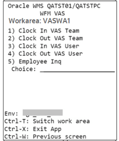

This RF screen provides options to clock users (or a Team) in a VAS activity. Regardless of the role of the logged in user, the following options are presented on selecting this RF screen:
WFM VAS
The default work area of the logged in user (clocker) is also displayed on this screen. If the clocker needs to clock a user or team into activities of a different work area, Ctrl+T can be used to switch work area and the selected work area is displayed on the screen.

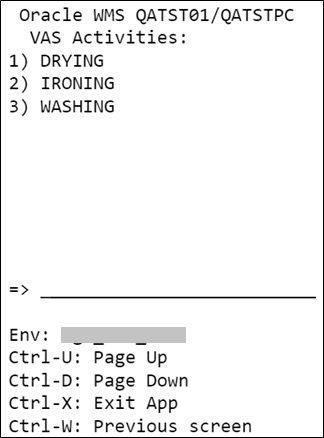

On selecting “Clock In Vas Team” or “Clock In Vas User”, all the VAS activities that have been configured in the selected Work Area are displayed in the next screen.

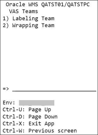

After selecting an activity, the logged in user is taken to the next screen, which shows all the Teams that are eligible to operate in this Work Area.
VAS Teams

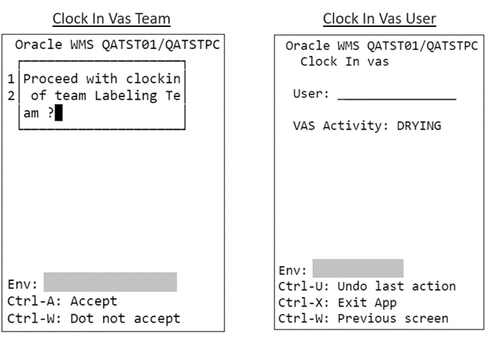

After selecting a team, the next screen varies, depending on the choice made on first screen. If “Clock In Vas Team” was selected, logged in user needs to confirm if the selected team can be clocked in. If “Clock In Vas User” was selected, the logged in user is prompted to enter the id of the user that needs to be clocked in.
Clock in VAS Team and User
Clocking in a team, clocks all the users of that team into the VAS activity.

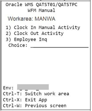

This RF screen provides options to clock users in a Manual activity. Regardless of the role of the logged in user, the following options are presented on selecting this RF screen:
WFM Manual
The default workarea of the logged in user (clocker) is also displayed on this screen. If the clocker needs to clock a user or team into activities of a different work area, Ctrl+T can be used to switch work area and the selected work area is displayed on the screen.

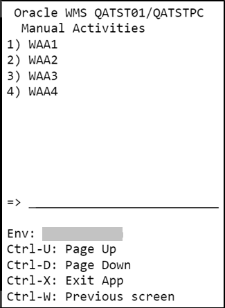

On selecting “Clock In Manual Activity”, all the manual activities that have been configured in the selected Work Area are displayed in the next screen.
Manual Activities
After selecting an activity, on the next screen, the logged in user is prompted to enter the id of the user that needs to be clocked in.
On selecting “Clock Out Activity” on the main screen, the logged in user is prompted to enter the id of the user that needs to be clocked out. The user is clocked out from the last clocked in manual activity.

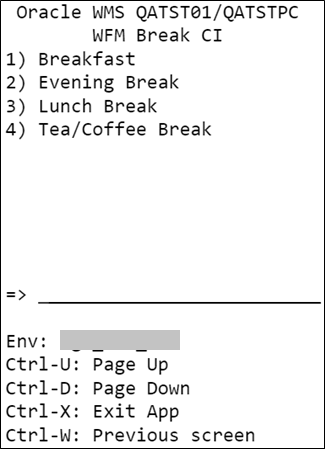

RF Break CI
Module: RF-Text: Break CI (wfm)
This RF screen can be used for clocking in users into a break. Regardless of the role of the logged in user, the following options are presented on selecting this RF screen:
WFM Break CI
After selecting a break option, on the next screen the logged in user is prompted to enter the id of the user that needs to be clocked into the selected break.

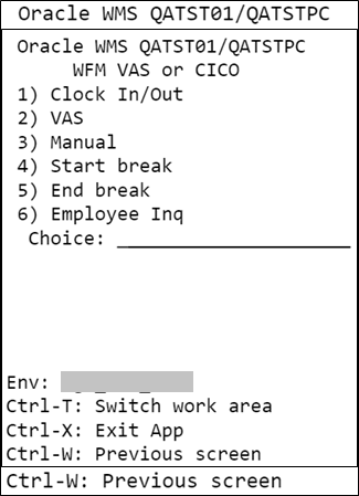

This RF screen acts as a one-stop screen that provides all the options that have been described in indvidual RF screens above. Regardless of the role of the logged in user, the following options are presented on selecting this screen.
WFM VAS or CICO
RF VAS or CICO Screen Menu Options
  1. Clock In/Out: Choosing this option takes you through the same screenflow as RF Cico.
  2. VAS: Choosing this option takes you through the same screenflow as RF VAS.
  3. Manual: Choosing this option takes you through the same screenflow as RF Manual.
  4. Start Break: Choosing this option takes you through the same screenflow as RF Break Cl.
  5. End Break: Choosing this option takes you through the same screenflow as RF Break CO.
  6. Employee Inq: Choosing this option takes you through the same screenflow as RF Employee Inq.

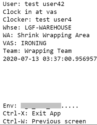

This RF screen does not provide any clock options but can be used to inquire about any user. The first screen prompts for a user and on keying in the id of a user, the last clock information about the user is displayed.
Last Clock Information
For example, in the screenshot above, the logged in user has requested information about test user42. The Employee Inq screen shows that the test user42 was last clocked into the “IRONING” VAS Activity by clocker test user 4 on July 13th at 03:37 am.

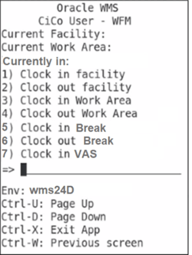

This RF screen supports only self-clocking unlike other RF clock screens that can be used by supervisors to clock other users. The logged in user is not prompted to enter any user id. Instead, on choosing any option on this screen, the logged in user is clocked into the chosen entity.
This screen can be used by any user regardless of their ROLE, as long it has been added to the user’s RF menu. On selecting this screen in RF, the following options are presented to the user:
RF CICO User
  • The "Current Facility", "Current Work Area" and “Currently In” provides a visibility of the entities in which the logged in user is currently clocked in, regardless of how the user was clocked in (Clock UI, RF clock options, Auto CICO, Input Interface, OR REST API) An empty value in these fields indicates that the user is not clocked into these entities.
  • Selecting 1 clocks the user into the logged in facility. No message is shown to the user, however the "Current Facility" field is updated.
  • Selecting 2 clocks the user out of the facility. If the user is currently clocked into a work area or any other entity such as break, VAS or manual, user is not allowed to clock out of facility.

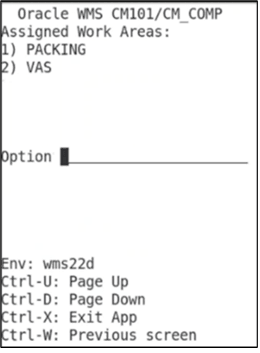

  • Selecting 3 takes the user to the next screen with a list of all work areas assigned to this user. Note that, unlike the existing WFM RF Clock options, this RF clock option, allows the user to clock into a work area even if it is not configured as the user’s default work area.
    Assigned Work Area
    After a work area has been selected, user is taken back to the main screen and the work area is displayed in the "Current Work Area" field.

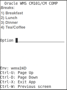

  • Selecting 5 takes the user to the next screen with all breaks configured in the facility.
    Breaks
    After a break has been selected, user is taken back to the main screen and the break is displayed in the “Currently In" field.

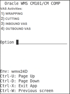

  • Selecting 7 takes the user to the next screen with all VAS activities configured in the clocked in Work Area.
    VAS Activities
    Note that user can either be in a VAS/Manual activity or in a break but not both. User can only clock into VAS/Manual activity after clocking out of break and vice-versa.
    After a VAS activity has been selected, user is taken back to the main screen and the activity is displayed in the “Currently In" field.
