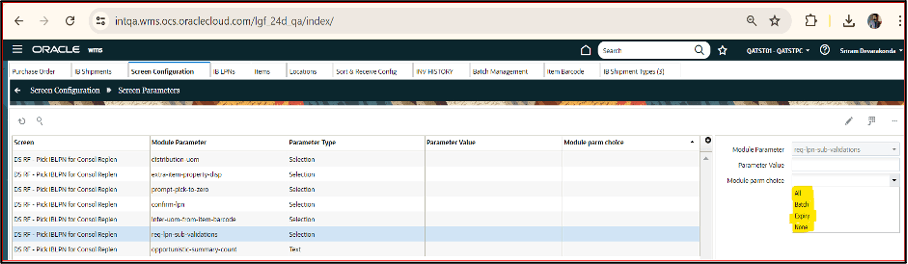

Allow Substitution during RF IBLPN Pick for Consolidate Replenishment
When handling an INTERNAL-PICK task, you can perform substitution of IBLPNs during the RF IBLPN Pick for Consol Replenishment operation (module: rf.inbound.cwrfpickiblpnreplen) ensuring better control over batch and expiry items. This helps you in managing inventory replenishment tasks, especially during time-sensitive or batch-specific items.
The substitution process includes updated validation messages to help you navigate the substitution of IBLPNs and reduces any potential errors.
Additionally, the screen parameter, req-lpn-sub-validations, you can decide whether to enforce validation based on batch numbers and expiry dates during substitution. This flexibility ensures that items requiring special handling, such as those with expiry dates, are correctly managed.
The req-lpn-sub-validations parameter offers four options, which allow you to define the level of validation required during the substitution process:
  • All: Both batch number and expiry date are validated during substitution.
  • Batch: Only the batch number is validated.
  • Expiry: Only the expiry date is validated.
  • None: No validations are enforced during substitution.
Allow Subsititution
Note: By default, this parameter is set to <Blank> for all existing screens. However, you can adjust it based on specific requirements to ensure smooth and accurate substitution during the RF Pick IBLPN process.
Substitution during the RF IBLPN Pick for Consol Replenishment process is only possible when the confirm-lpn screen parameter is set to Yes. This setting ensures that the system confirms the LPN being processed, providing a safeguard against invalid substitutions.
During the picking process, if an IBLPN that does not match the prompted LPN is scanned, the system will display the following messages based on the situation:
  1. Message 3177: If the scanned IBLPN is from the same pick location, the system will prompt, ‘Do you want to substitute LPN Number %s?’ This gives the you an option to confirm the substitution.
  2. Message 3178: If the scanned IBLPN is from a different pick location, the system will prompt, ‘Do you want to substitute LPN Number %s from a different location?’ This message ensures that you are aware of the location discrepancy before confirming the substitution.
Note: These messages ensure that only valid substitutions are made based on location and other parameters.
You also have the option to disable these messages entirely to configure substitution message warnings that are unnecessary.
