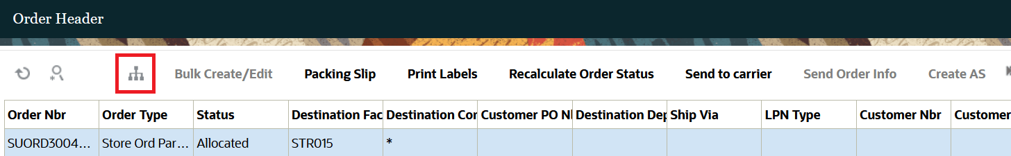

- Go to the Order Header (OrderHdrView) UI.
- Select an order in “Allocated” or “Partly Allocated” status.Note:

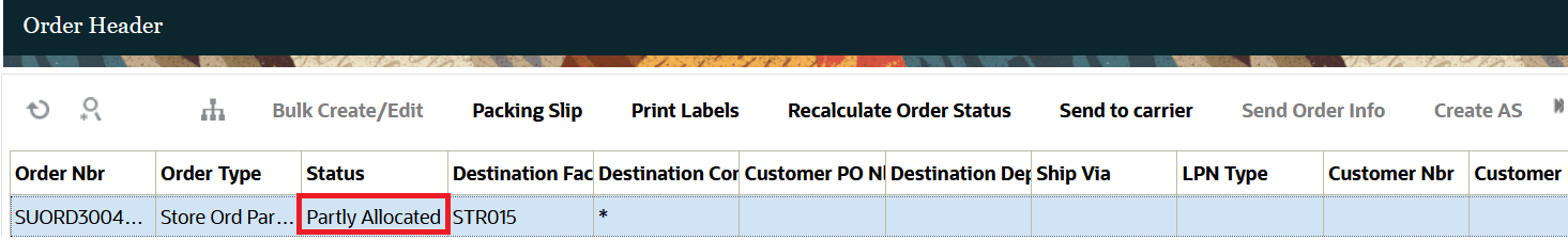

- For an allocated order, you can only increase the ordered quantity. If you update the ordered quantity more than the allocated quantity, then the system updates the order status to “Partly Allocated”.

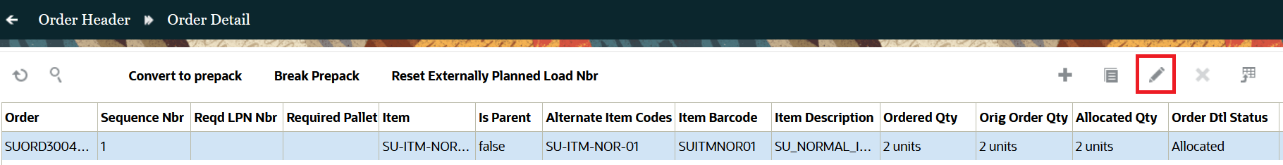

- In the Order Detail screen, select an order detail record to update ordered
quantity and click Edit action button.
- Update the Ordered Quantity based on your requirement.
- Click Save.Note:

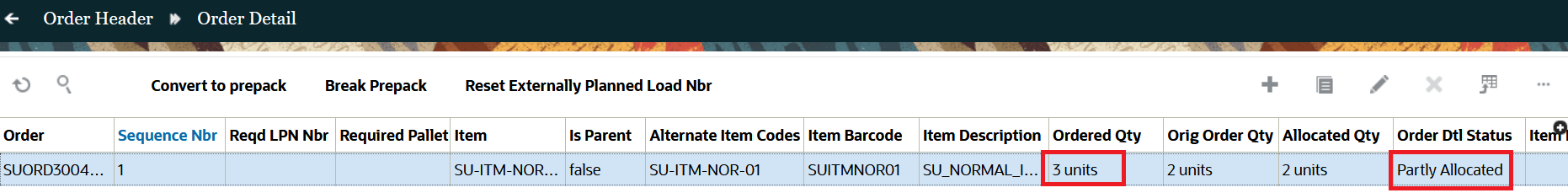

The system updates the Order Detail status based on the updated Ordered Quantity as shown in the figure below:
And the Order Header screen displays the updated order status based on the order detail status.

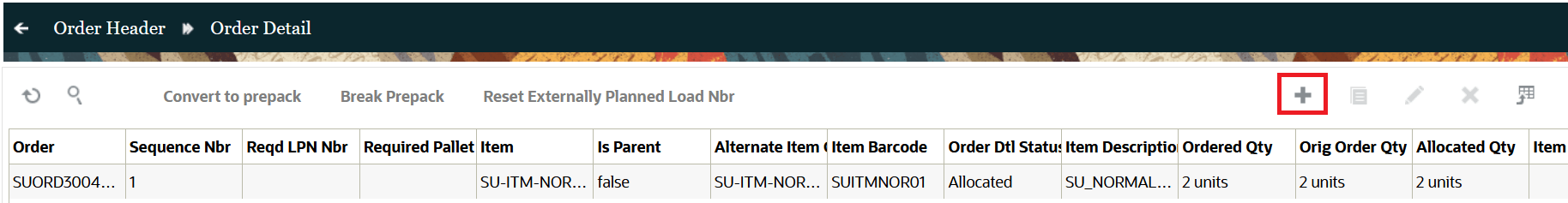

- To add a new order line:
- Click Create action button.
- On the create pane, based on your requirement, add details and click Save.

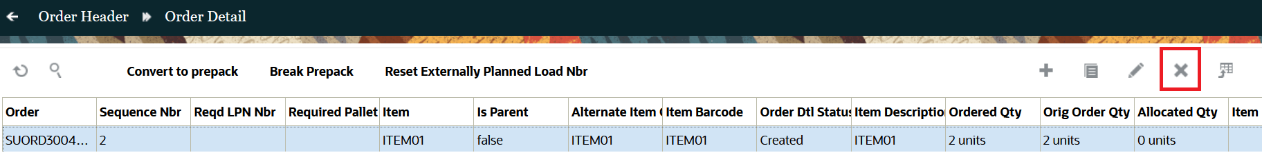

- To delete an order line:
- Select the order line to delete and click Delete action
button.
Note: You can delete the order detail only if the if the order detail is unallocated. - Select the “Reason Code” in the Delete pop-up and click
Submit.Note: On deleting an order detail having transportation split and in “Created” status with more than one split order details with allocations, after entering the Reason code prompt, the system displays an error message “Cannot delete order detail which has gone through transportation split.”.
