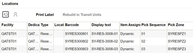

  1. First, you will create three Reserve locations. Each reserve location belongs to a different pick Zone:
Reserve Locations

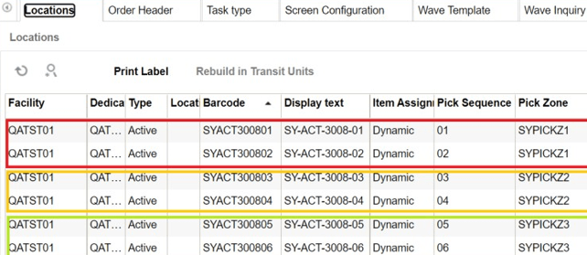

  • Then, create six Active Locations:
There are three Pick Zones. In each Pick Zone there are two Locations:
Pick Zone Locations

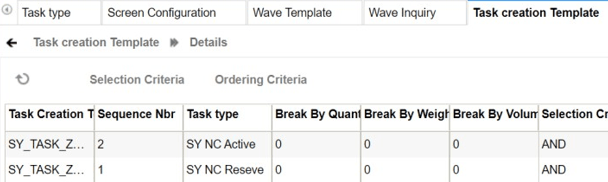

In the Task Creation Template UI, no Selection Criteria has been configured, and the Ordering Criteria has been set to Order Header, Order Number with a Break by Count = 1 in Reserve and Active locations.

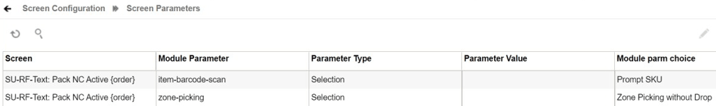

For RF Pack NC Active, we have configured the zone-picking module parameter with the Zone Picking without Drop parameter choice.
Zone Picking Without Drop

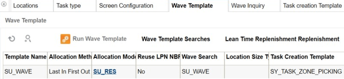

In the task creation template in the wave, the Allocation is from Reserve and Active.
Allocation Mode
  1. Run the wave template for all three orders with the above data setup.
    In the Wave Inquiry Screen, the system has created a fourth task. There is one task for Reserve and three Tasks for Active. You will be able to see the that the status in the Task UI is “Ready” and “Allocated” in IB LPN UI. In the Active Inventory UI, the status is Active and in the Order UI, the status is “Allocated.”
