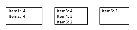

The current cubing feature of WMS use an algorithm that relies on strict ordering and capacity checks. For example, a configuration which orders by item barcode, allowing for up to three distinct items per LPN and targeting an LPN type with a max volume of 10 would yield the following results:
Configuration by Item Barcode
Resulting LPN utilization:
  • LPN1: 80%
  • LPN2: 90%
  • LPN3: 20%
