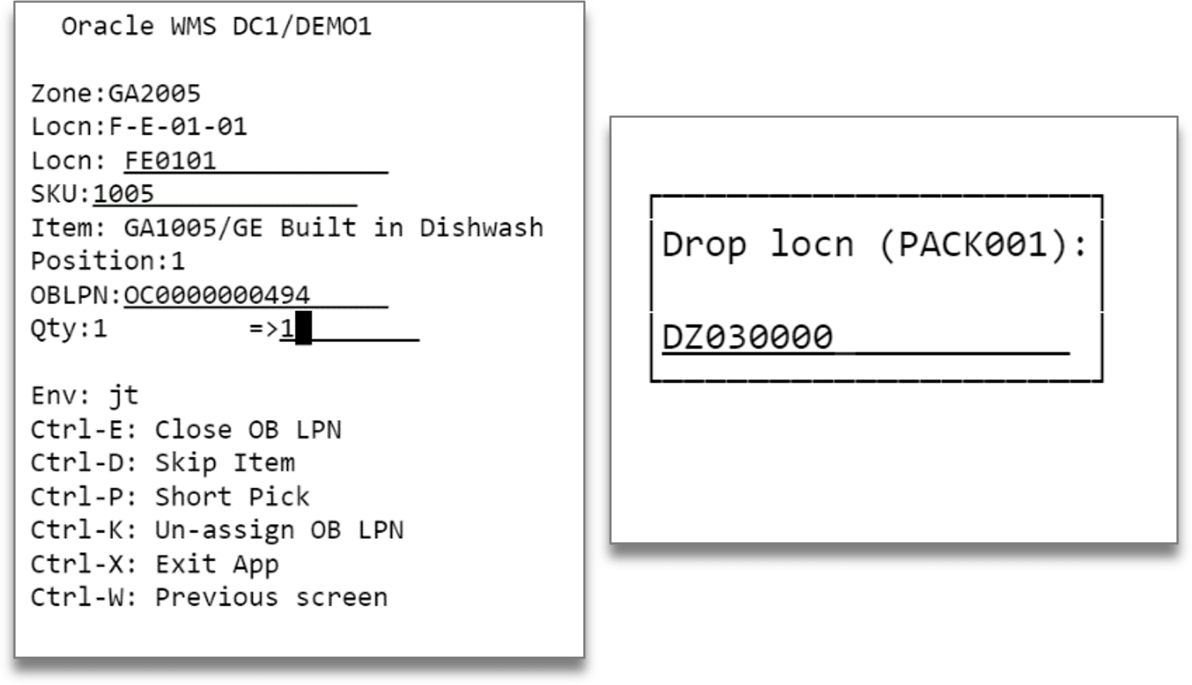

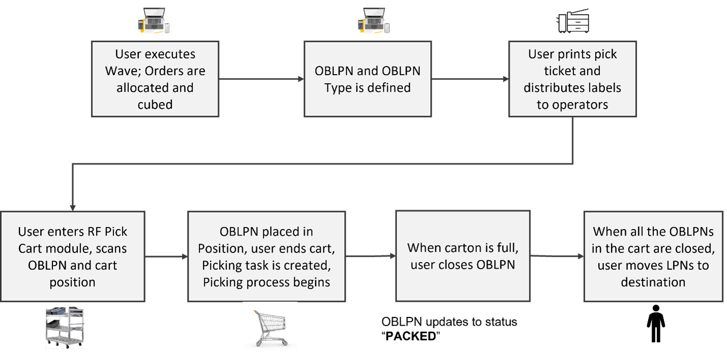

Creating Pick Cart Tasks
You can create pick cart tasks using the following steps:
  1. Prior to picking process, scan a pick cart to begin assigning OBLPNs to a Pick Cart task.
  2. Upon scanning each OBLPN during picking, the system will assign a Position Number to the cart that helps you in directing a product to the correct OBLPN.
  3. Press CTRL+E to close the Pick Cart (or you can scan until you reach the maximum allowed OBLPNs). This will create a Pick Cart task.
    Note: The Task Details will be sequenced by Location Pick Sequence.
    Pick Cart Task
Executing Pick Cart Tasks
  1. Picks are executed on the task based on Location Pick Sequence.
  2. You will be prompted for Location, Item, and Quantity based on screen parameters you configure.
    On the LPN/SKU/Quantity scan screen, you can use the “Ctrl-V: View Details” hotkey to view the following allocated inventory details for the scanned SKU.

  3. You can confirm picks by scanning the OBLPN barcode or the Position Number based on screen parameters.
  4. After all picks are complete, you can locate the Pick Cart and all OBLPNs to a drop zone location, if necessary.
    Execute Pick Cart
  5. Upon completion, the task Status is updated to Completed.
