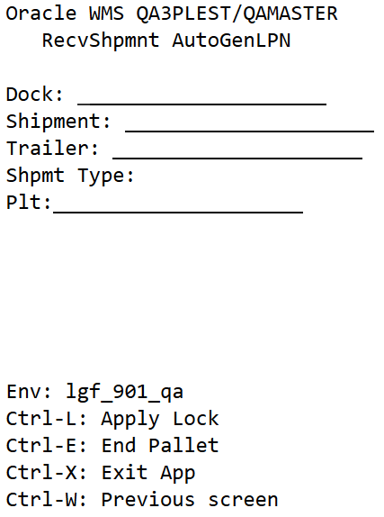

  1. On the first screen, after entering the inbound shipment and pallet nbr, you are taken to the SKU scan screen.
    SKU Scan screen
  2. On the SKU scan screen, the Ctrl-E key will activate “End Pallet”.
    • If you hit Ctrl-E, the system displays the message “End pallet <plt nbr>?”
      If you accept the message, the system ends the pallet and takes you back to the first screen and prompts you for a Pallet.

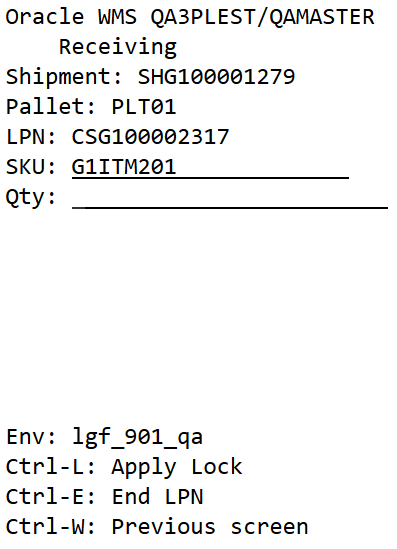

    • If you scan a SKU, an LPN nbr will be auto-generated. The Ctrl-E control key is now displayed as End LPN.
      End LPN Control Key
      • If you press Ctrl-E, the system displays the message “Nothing to receive.”
      • If you enter the quantity, press tab/enter and then Ctrl-E, to end the LPN. The LPN field is now blank and Ctrl-E is displayed as End Pallet.
