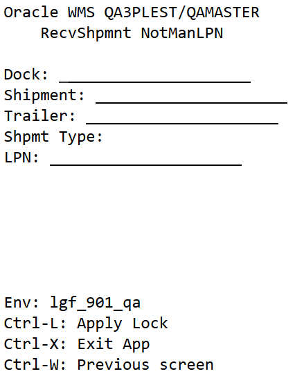

Screen Flow when lpn-prompt is Configured as Not Mandatory
  1. Select the Shipment/ Load option which has “lpn-prompt” configured as Not Mandatory. TheLPN Prompt is displayed.
    LPN Prompt
  2. When “lpn-prompt” is configured as Not Mandatory, it is mandatory to enter the Shipment Nbr/Load Nbr.
    1. If the shipment’s load is checked in to a dock door, enter the dock door. This will automatically populate the Shipment Nbr on that dock.
  3. After you enter the Shipment/Load Nbr, you can choose to scan the LPN Nbr or skip it. On the next screen, the system prompts for SKU and Qty. If the LPN was scanned on screen 1, it is displayed on this screen. Otherwise the LPN field remains blank.
    If LPN not scanned on previous screen
  4. After scanning the first SKU, the system generates an LPN Number based on the sequence counter BLIND_LPN_NBR, if the LPN Nbr was not scanned on the first screen.
    1. If the LPN is scanned on screen 1 and if the screen parameter “pallet-handling” is configured as LPN or Pallet receiving, then the system assumes that an LPN is being received and generates an LPN Number based on sequence counter BLIND_LPN_NBR.
