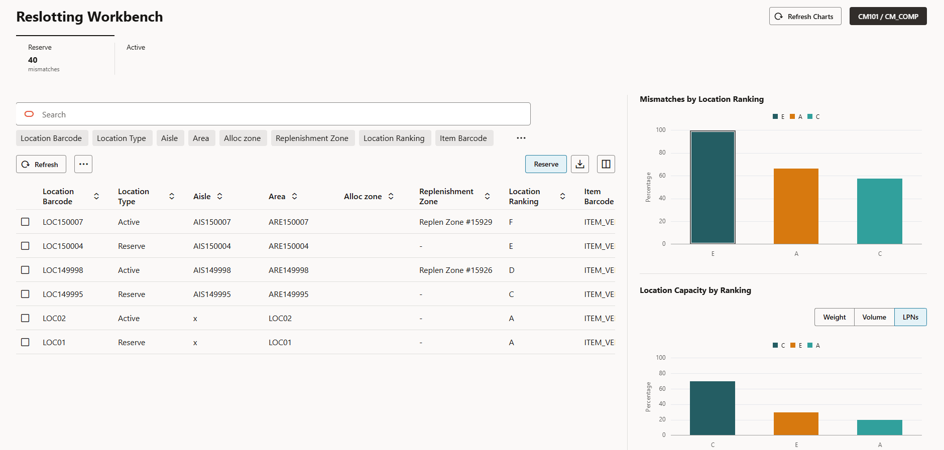

The intuitive Reslotting Workbench (UI) is designed to help warehouses optimize inventory placement based on product velocity, seasonality, and demand patterns. This UI helps improve operational efficiency by reducing picker travel times and congestion with smarter inventory placement.
You can view important location and item details and Key Performance Indicators (KPIs) all in one Workbench style display:
Reslotting UI with Location Ranking and Location Capacity Display
On the left pane, the UI includes a user-friendly data grid where you can Search, filter, and sort by critical fields such as Location, Ranking, Item, Facility, Inventory Cost, and more.

When you are viewing the Workbench Graph KPIs / Location Capacity by Ranking, you can toggle between 3 metrics.
  • You can view Active Locations metrics by: Volume, Weight, Units
  • You can view Reserve Locations metrics by: Volume, Weight, LPNs
Note: The colors for the bars on the charts will always display in the same order. (that is green, orange, teal.) The colors are not based on their Ranking.
