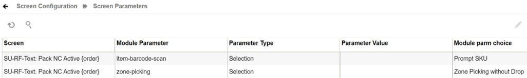

RF Pack NC Active {order} is configured with the Zone Picking parameter, and “Zone Picking without Drop” parameter choice.

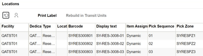

  1. First, you will create three Reserve locations. Each reserve location belongs to a different pick Zone:
Reserve Locations

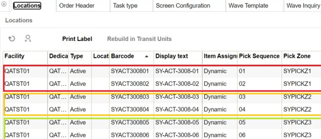

  • Then, create six Active Locations:
There are three Pick Zones. In each Pick Zone there are two Locations:
Pick Zone Locations

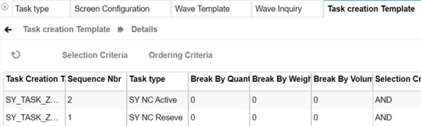

In the Task Creation Template UI, no Selection Criteria has been configured, and the Ordering Criteria has been set to Order Header, Order Number with a Break by Count = 1 in Reserve and Active locations.
For Pack NC Active, we have configured the zone-picking module parameter with the Zone Picking without Drop parameter choice.
Zone Picking Without Drop

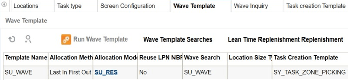

In the task creation template in the wave, the Allocation is from Reserve and Active.
Allocation Mode
  1. Run the wave template for all three orders with the above data setup.
