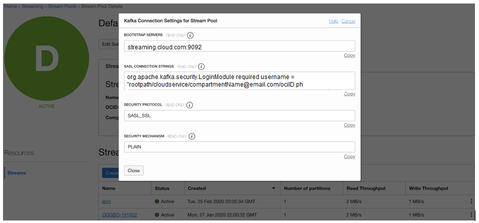

Technology Settings
Configure the following technology settings:
- Bootstrap Servers – Specifies one or more OCI Streaming bootstrap servers used to establish the initial connection. This field is required.
- Stream Pool – Specifies the OCI Stream Pool associated with the target streams, when required by the deployment.
Configure the Security Settings section
Security Settings
Configure the following security settings:
- Security Protocol – Specifies the communication protocol. Supported values are PLAINTEXT and SASL_SSL.
- SASL Mechanism – Specifies the SASL authentication mechanism used by OCI Streaming.
- Username – Specifies the user name required for SASL_SSL authentication.
- Password – Specifies the password required for SASL_SSL authentication. This field is treated as sensitive information.
- Truststore – Upload the Base64-encoded truststore file used to validate the OCI Streaming server certificate. This property is deprecated and will be replaced by trustStoreSecretId.
- Truststore Password – Specifies the truststore password. This property is deprecated and will be replaced by trustStorePasswordSecretId.
- Keystore – Upload the Base64-encoded keystore file containing the client certificate and private key. This property is deprecated and will be replaced by keyStoreSecretId.
- Keystore Password – Specifies the keystore password. This property is deprecated and will be replaced by keyStorePasswordSecretId.
- SSL Key Password – Specifies the password protecting the private
key contained in the keystore when it differs from the keystore password. This
property is deprecated and will be replaced by sslKeyPasswordSecretId.
Configure the authentication and SSL properties only when Security Protocol is set to SASL_SSL.
