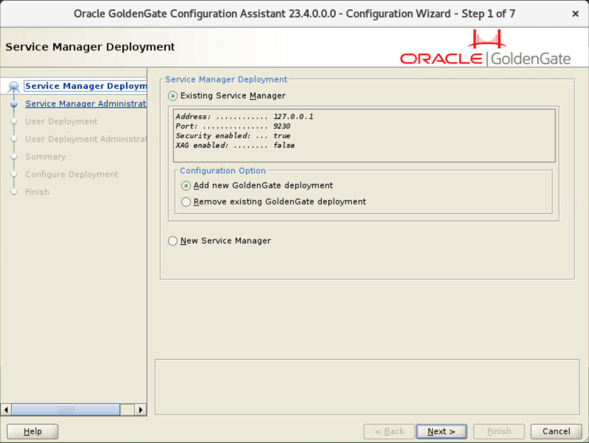

The OGGCA configuration wizard is displayed. Existing Service Manager option is preselected in the Service Manager Deployment screen.
Options to add a deployment to an existing Service Manager
Use the following steps to add a deployment to the existing Service Manager:
  1. From the Configuration Options section, select Add new GoldenGate deployment to add a deployment the existing Service Manager and click Next.

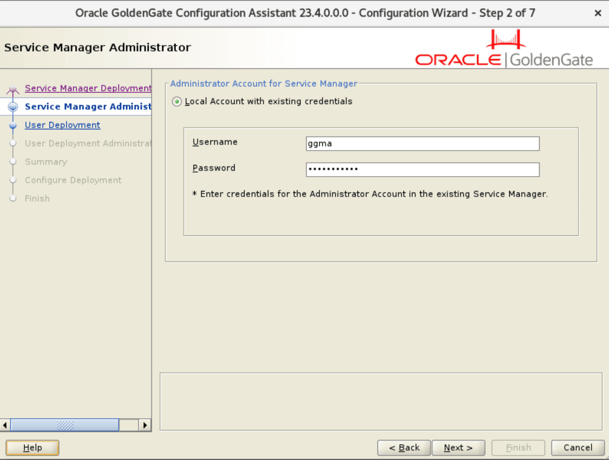

  2. On the Service Manager Administrator Account screen, specify the Service Manager login credentials for the existing Service Manager and click Next, as shown in the following image.
    Enter the user login credentials for the Service Manager administrator account for the existing Service Manager.
