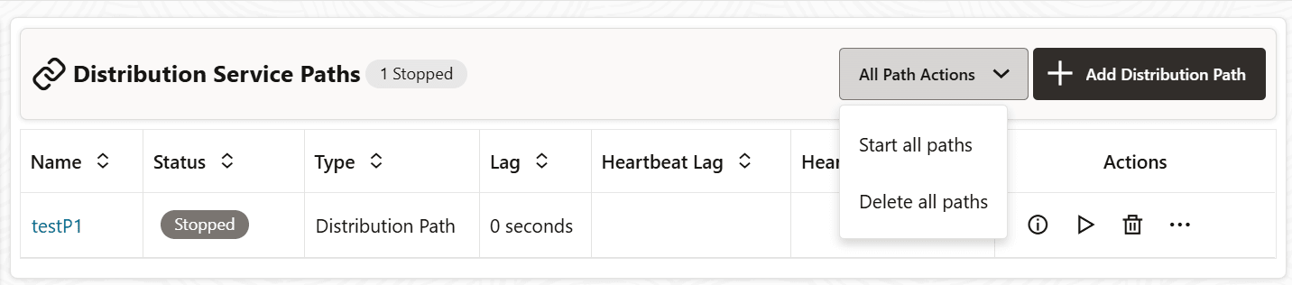

From the left-navigation pane, click Distribution Service Paths. The Distribution Service Paths page is displayed. To start and stop all distribution service paths associated with the deployment, you can select the Start All Paths or Stop All Paths options from the All Path Actions drop down list.
Options under All Path Actions drop down button when all distribution service paths are stopped.

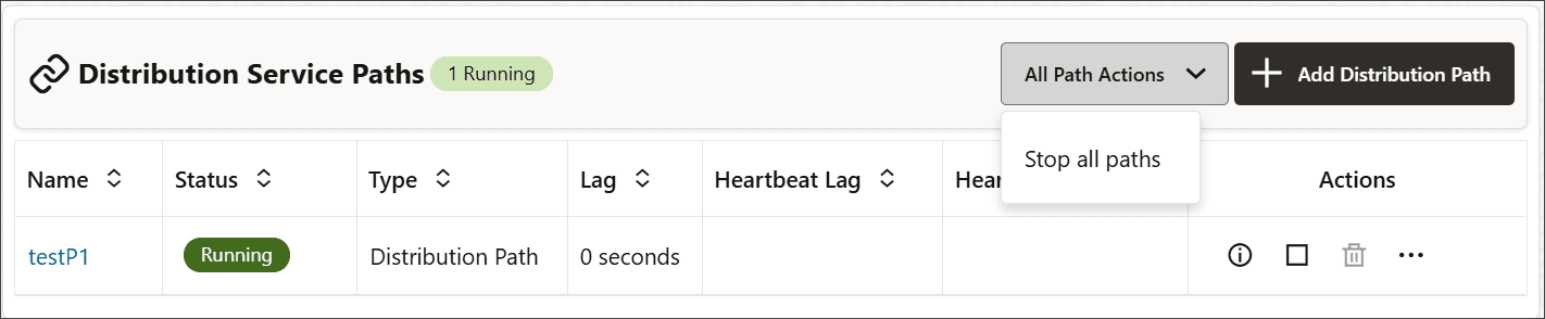

If the distribution service path is running, then the All Path Actions drop-down menu displays the option to Stop all paths.
Stop all paths using the All Path Actions drop-down button. Use the Actions column to stop, delete, reposition, and change filtering for a path.
