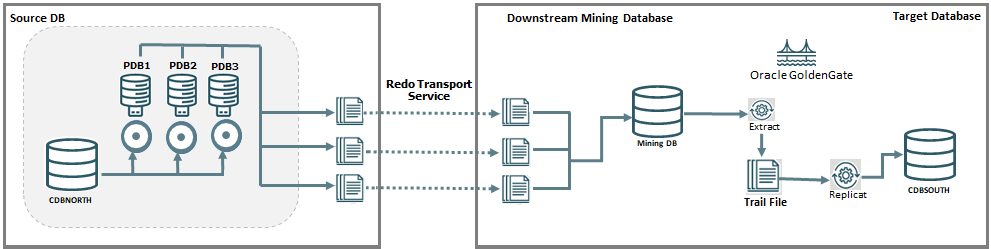

In a typical downstream deployment, the source database, where changes are made to the data, will ship it's redo logs or archive logs to a mining database where the Extract process will mine the redo logs and write out the trail files. Downstream Extract can also be used in situations where Oracle GoldenGate cannot establish a connection with the source database. In the following diagram, CDBNORTH is the source database and CDBSOUTH is the target database. There is a mining database between the source and target with the database logmining server that transfers redo logs from the downstream Extract to the target.
Workflow between source multitenant container database and a downstream database with logmining server.
