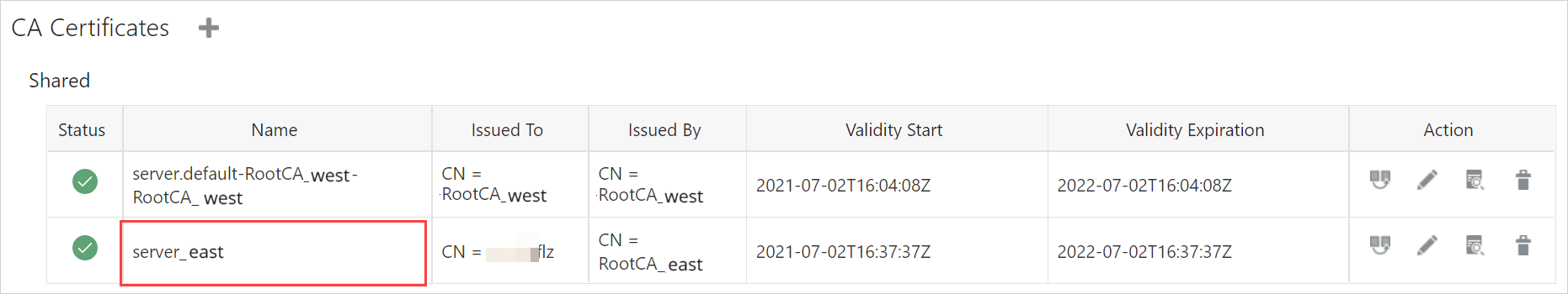

  2. At the source, add the target Server CA certificate (server_east).
    The Distribution service on the source system must trust the target server certificate, which is authorized by the server_east target server CA certificate. This is added to the source secure store.Target Server CA certificate is added to the Source deployment.

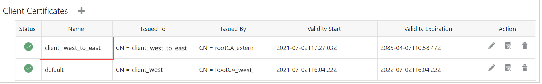

  3. At the source, add a Distribution Path Client Certificate. The Distribution Path Client certificate is created in addition to the initial setup and is used connecting the Distribution Path to the target. This client certificate is signed by another trusted Root CA certificate (rootCA_extern), which is added to the target deployment. Both certificates are independent from the certificates from the initial deployment of the Oracle GoldenGate source and target instances.Client certificate generated using OpenSSL added to the source deployment.

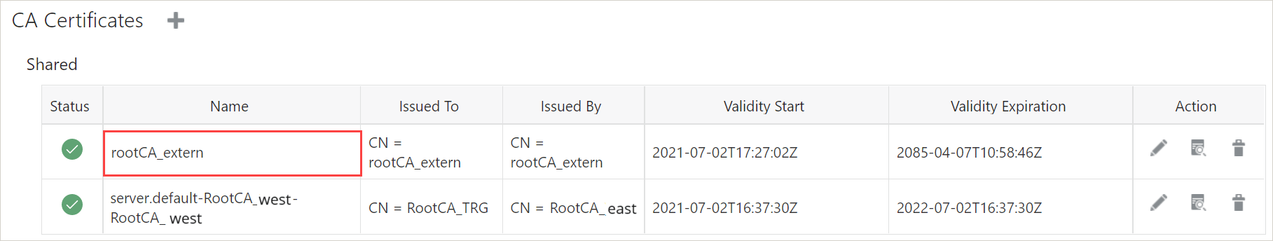

  4. At the target, add the trusted Root certificate rootCA_extern for the client certificate client_west_to_east, which was added to the source deployment. The rootCA_extern certificate is added as the CA Certificate for client_west_to_east certificate. The Receiver Service on the target system must trust either the client certificate or the issuer of the client certificate. This needs to be added to the target secure store.rootCA_extern Root certificate generated using OpenSSL is added on the target deployment.
