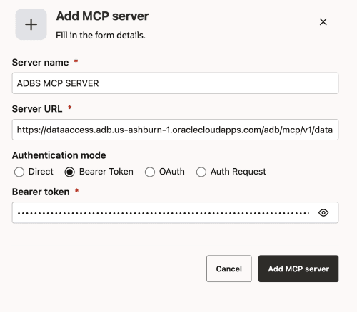

Step 3: Connect to Agent Factory:
- In the left-hand navigation, click MCP Servers under Utilities.
- Click Add MCP Server.
- Paste the URL from step 1.2 in the URL field.
- Select “Bearer Token” as the Auth Type.
- Obtain a bearer token by calling the following endpoint:
curl --location 'https://dataaccess.adb.{region-identifier}.oraclecloudapps.com/adb/auth/v1/databases/{database-ocid}/token' \ --header 'Content-Type: application/json' \ --header 'Accept: application/json' \ --data '{ "grant_type":"password", "username":"<your_username>", "password":"<your_password>" }' - Paste the bearer token in the Bearer Token field.
The configuration should look similar to this:
- Drag and drop an MCP Server node from the Tools category onto the Agent Builder canvas. Make sure to select your newly added MCP Server from the dropdown. See MCP Server Node.
