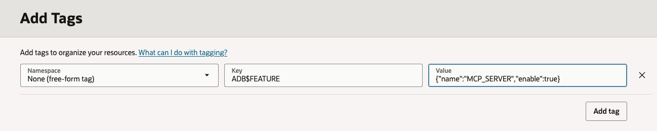

  1. You can enable the MCP server by adding the following OCI free-form tags in the OCI Console as an OCI user with permissions to update the database. This enables access to custom Select AI Agent tools. See Understanding Free-form Tags for more information.
    Tag Name: adb$feature Tag Value: {"name":"mcp_server","enable":true}
    For example:
    Free-form tag for enabling MCP server
    Enabling the MCP Server creates a remote endpoint for the MCP server that is associated with the database OCID. After you enable MCP server, the database exposes its remote MCP server endpoint. MCP clients can use this endpoint to run Select AI agent tools directly from the database.

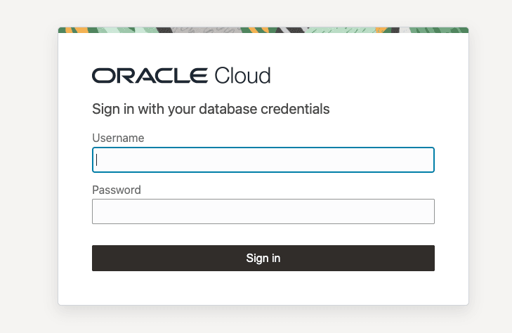

    If you are using client applications that support OAuth authentication such as Claude Desktop, a login screen is displayed. Enter your username and database credentials on the login screen.
    Login screen
    Note
    For bearer token-based authentication, login screen is not displayed.
    The application displays only the Select AI tools you are authorized to access, and automatically uses the appropriate tools based on your natural language prompt.
