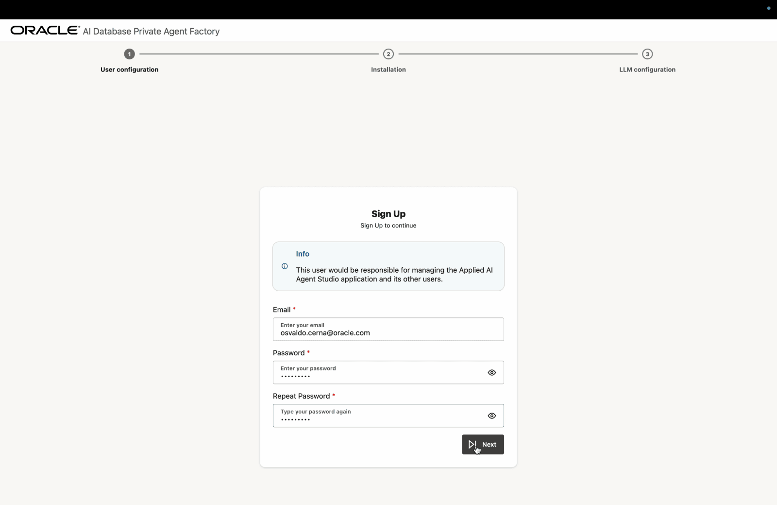

Configure User
Set up an email and a secure password.
User Configuration

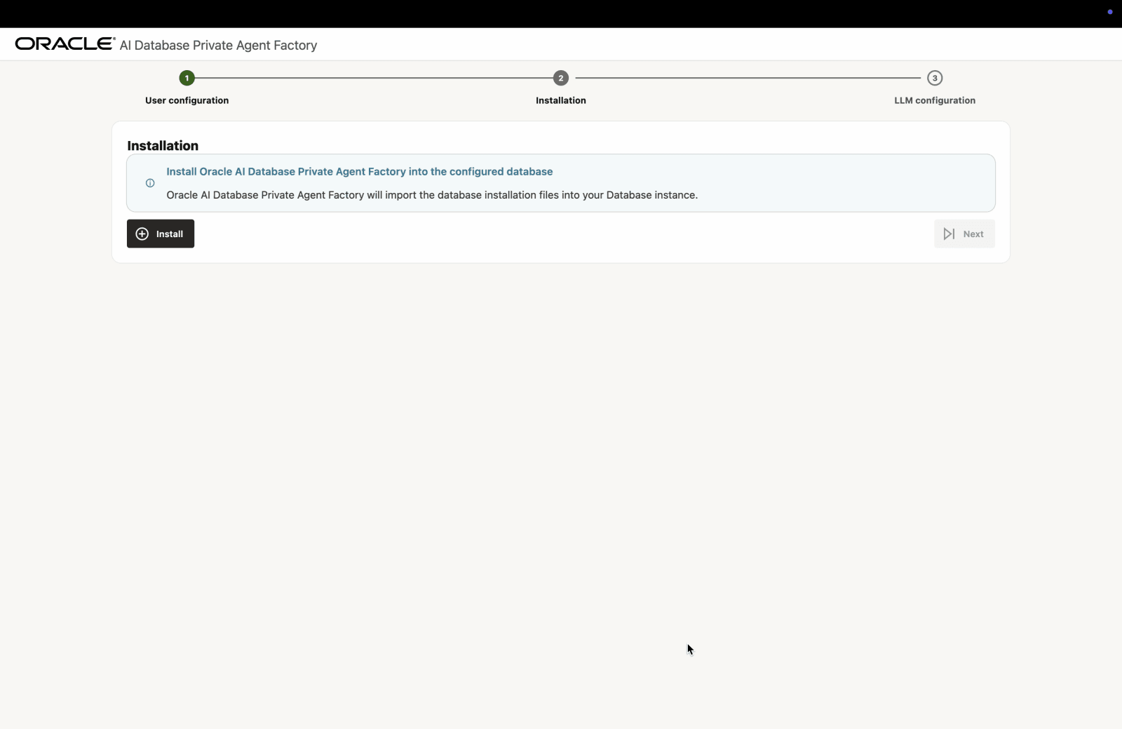

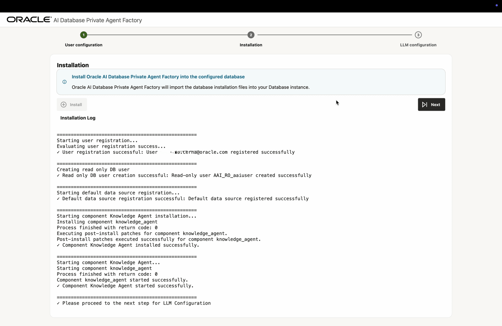

Install Components
Click Install and wait a few minutes for the setup to complete.
Components Installation
When finished, you will see the message ✓ Please proceed to the next step for LLM Configuration. Click Next.
Successful Installation

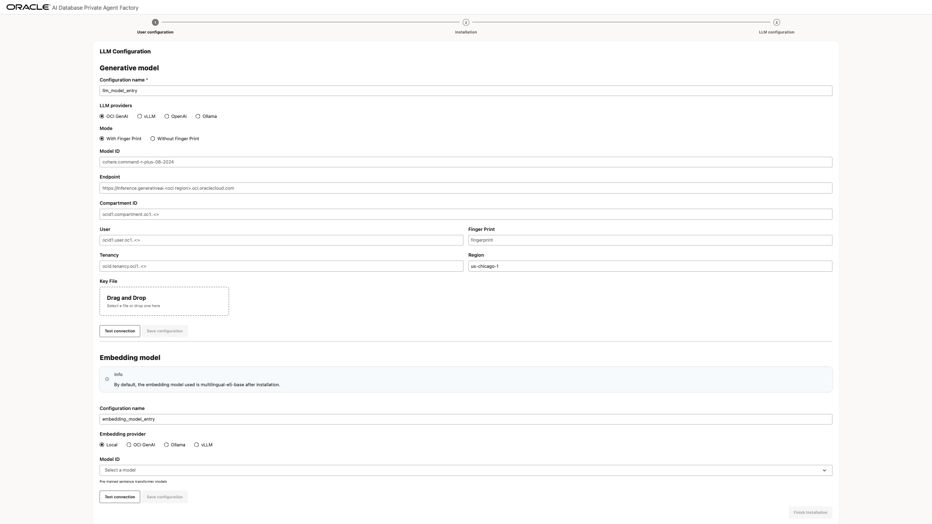

Configure LLM
Before you continue, see Manage LLM to review the supported models and LLM providers, and how to set them up.
Select an LLM configuration based on your LLM provider. The application supports integration with Ollama, vLLM, OpenAI, and the full suite of OCI GenAI offerings. Depending on your selected provider, the required connection credentials may differ.
LLM Configuration
Enter the required details in the selected LLM configuration and select Test Connection. Once you see the Connection successful message, select Save Configuration.
Optionally, configure an embedding model to use for data ingestion and retrieval. By default, multilingual-e5-base model is used to generate embeddings and is also the local embedding model included with the service. If you choose OCI GenAI as the embedding provider, note that the following embedding models are supported for Knowledge Agents.
Finally, select Finish Installation to complete the setup and be redirected to the login page.

Configure User
Quick Start Mode: User Configuration
Install Components
Quick Start Mode: Components Installation
Quick Start Mode: Successful Installation
Configure LLM
LLM Configuration

Configure User
User Configuration

  2. Click Test Connection to verify that the information entered is correct. Upon a successful connection, you will see a ‘Database connection successful’ notification. Click Next.
Install Components
Configure LLM
LLM Configuration

Configure User
Install Components
Configure LLM
LLM Configuration
