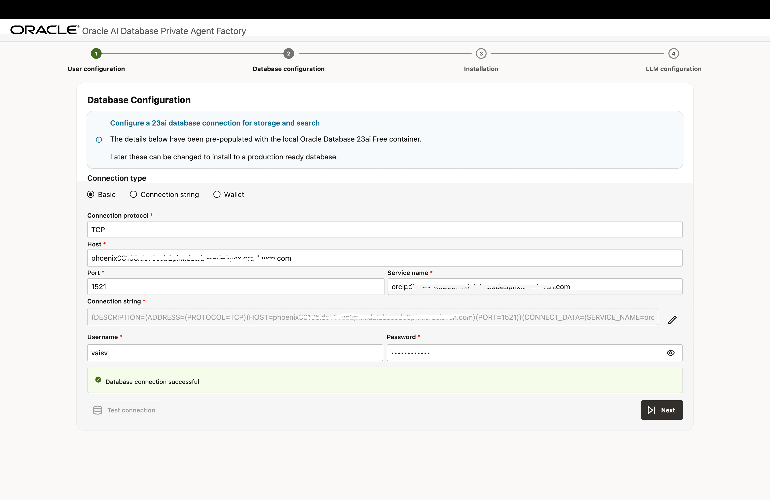

Configure Database Connection
Provide your database connection details. You can either enter the Oracle AI Database 26ai connection details directly, provide the connection string or upload a database wallet file, along with a user and password.
Basic: Enter all the connection details manually and the previously created database user and password.

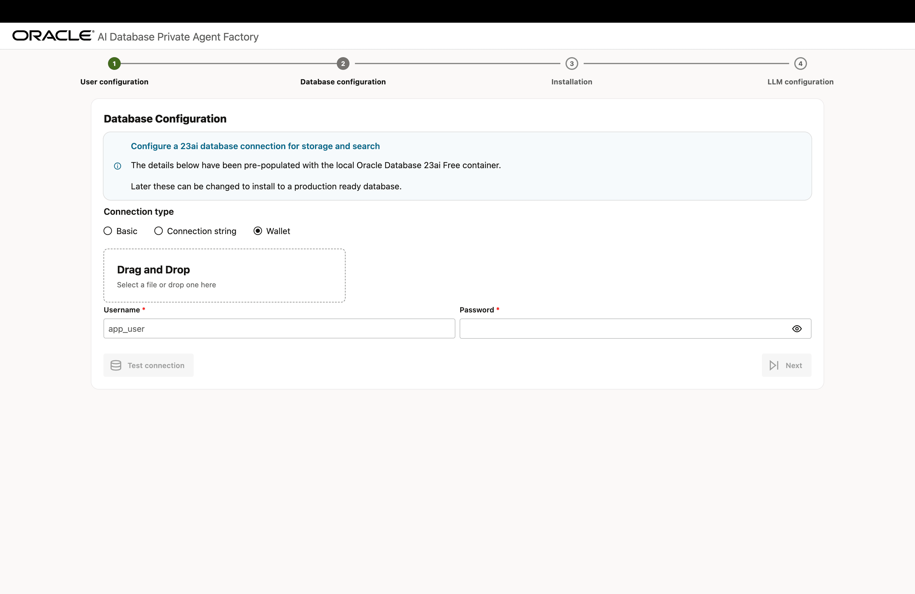

Wallet: Upload a Database Wallet File and enter the previously created database user and password.

Click Test Connection to verify that the information entered is correct. Upon a successful connection, you will see a ‘Database connection successful’ notification. Click Next.

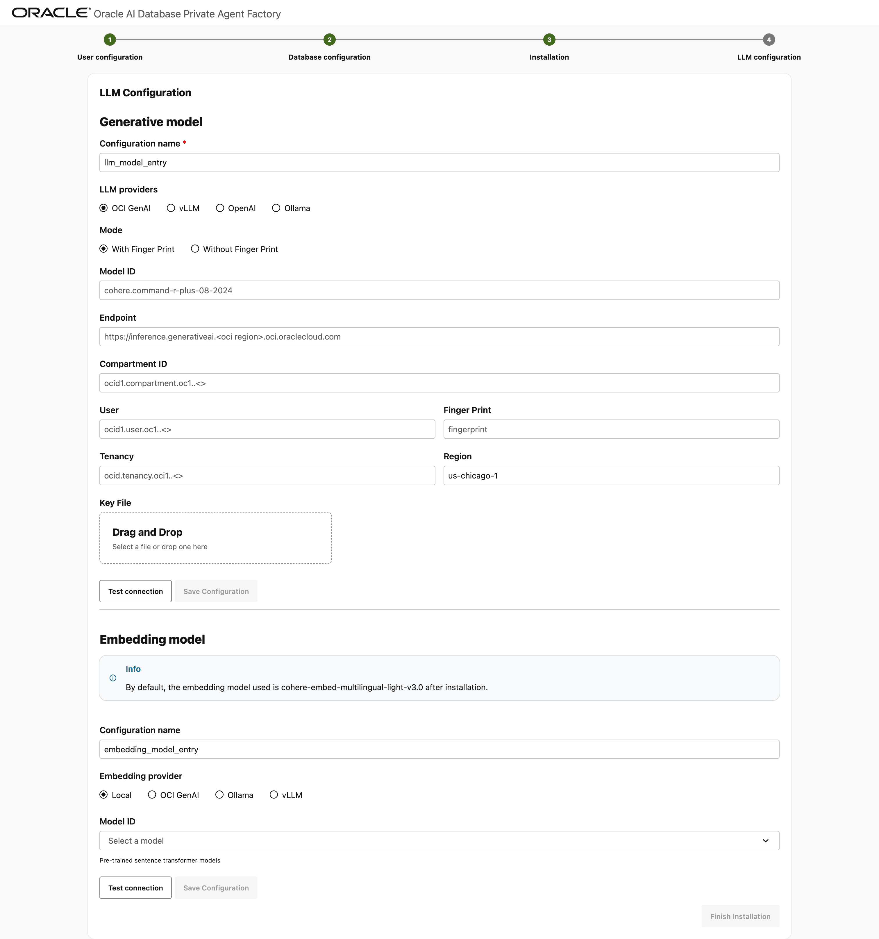

Configure LLM
Before you continue, see Manage LLM to review the supported models and LLM providers, and how to set them up.
Select an LLM configuration based on your LLM provider. The application supports integration with Ollama, vLLM, OpenAI, and the full suite of OCI GenAI offerings. Depending on your selected provider, the required connection credentials may differ.
Enter the required details in the selected LLM configuration and select Test Connection. Once you see the Connection successful message, select Save Configuration.
Optionally, configure an embedding model to use for data ingestion and retrieval. By default, multilingual-e5-base model is used to generate embeddings and is also the local embedding model included with the service. If you choose OCI GenAI as the embedding provider, note that the following embedding models are supported for Knowledge Agents.

Configure LLM
To successfully install the Oracle AI Database Private Agent Factory Knowledge Assistant when using database wallets, Agent Factory requires the database environment to be outside an air gapped environment and able to access OCI Object Storage using Pre-Authenticated Request (PAR) files. Verify whether
WALLET_LOCATIONorENCRYPTION_WALLET_LOCATIONis specified in thesqlnet.orafile on the database server. If either is configured, ensure that the required OCI certificates are added to the wallet. If the certificates are not present, add them to the wallet to enable access to Object Storage files. Please note that not installing Oracle AI Database Private Agent Factory Knowledge Assistant, which answers questions on this documentation, does not impact the Private Agent Factory or the Knowledge Agent component.Click here to download the certificates you need to add to the wallet. Below example assumes that the SSL wallet is located at
/u01/app/oracle/dcs/commonstore/wallets/ssland that you have unpacked the certificates in/home/oracle/dbc:#! /bin/bash # Check if the certificates are available under "Trusted Certificates" orapki wallet display -wallet /u01/app/oracle/dcs/commonstore/wallets/ssl # Add certificates if they are missing for i in $(ls /home/oracle/dbc/DigiCert*cer) do orapki wallet add -wallet /u01/app/oracle/dcs/commonstore/wallets/ssl -trusted_cert -cert $i -pwd <SSL Wallet password> doneSee Create SSL Wallet with Certificates for more details.

Configure LLM
- cohere.embed-v4.0
- cohere.embed-english-v3.0
- cohere.embed-multilingual-v3.0
- cohere.embed-multilingual-light-v3.0
Finally, select Finish Installation to complete the setup and be redirected to the login page.
