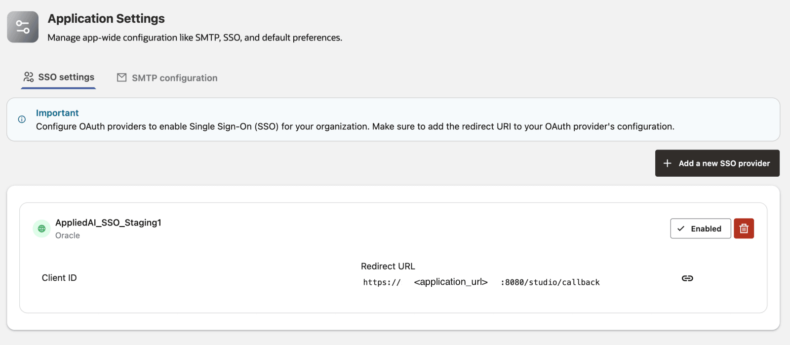

In Agent Factory, select Application settings from the left sidebar, then select the SSO settings tab.
Select Add a new SSO provider button and copy the Redirect URL at the bottom of the form.

Fill in the SSO credentials in the Add a new SSO provider form.

Note: Please ensure that your newly created SSO configuration is enabled.
Click Enable to activate it if it is currently disabled.
Also verify that the Client ID and Redirect URL are correct and free of typos or mismatches.
