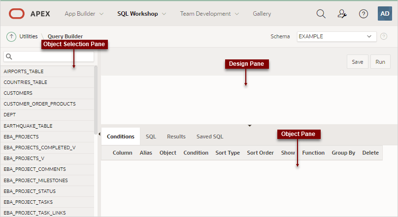

The Query Builder page is divided into three sections:
  • Object Selection pane displays on the left side of the page and contains a list objects from which you can build queries. Only objects in the current schema display.
  • Design pane displays to the right of the Object Selection pane and above the Conditions, SQL, Results, and Saved SQL tabs. When you select an object from the Object Selection pane, it appears in the Design pane.
  • Output pane displays below the Design pane. Once you select objects and columns, you can create conditions, view the generated SQL, or view query results.
