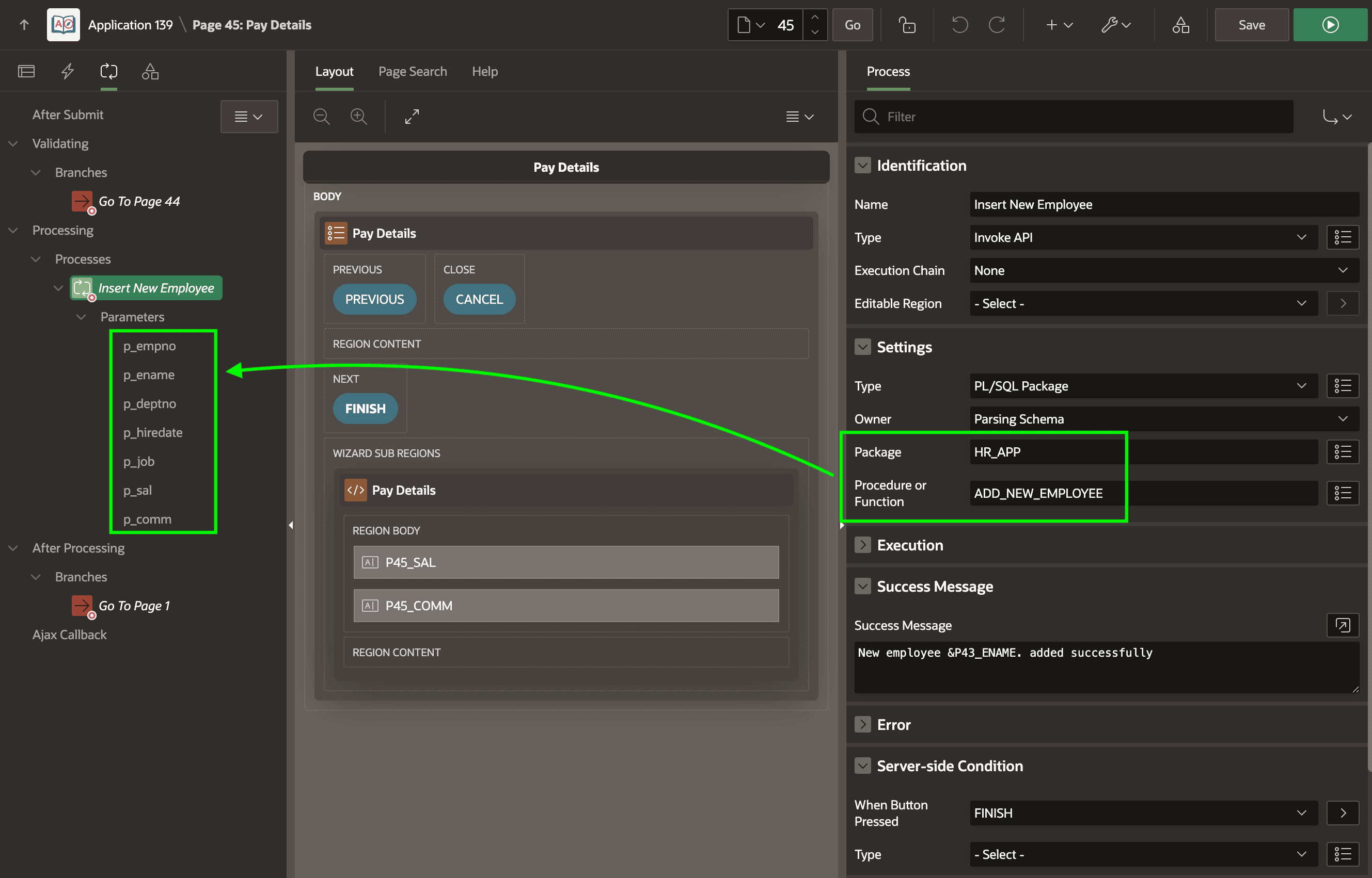

Then the Insert New Employee page process in the Onboard New Employee wizard can change to use the Invoke API native page process, configuring the package and procedure name as shown below. After setting the Package and Procedure name, the Processing tab updates to show the procedure's parameters under the Parameters section of the page process.
Figure 8-11 Configuring Invoke API Process to Call Package Business Logic

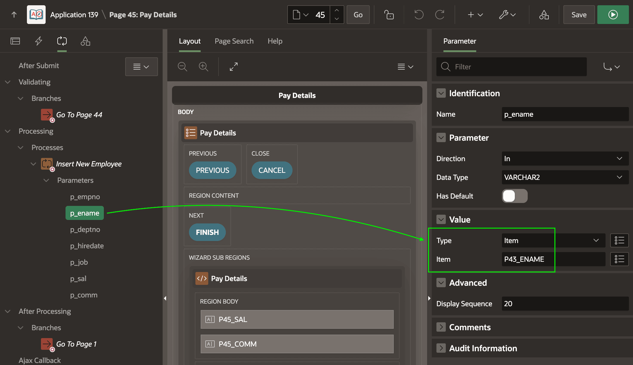

Where possible, Page Designer automatically maps matching page item names in the current page to provide appropriate parameter values. You can inspect and configure any of the parameters using the Property Editor as shown below.
Figure 8-12 Configuring Parameter Values for Invoke API
