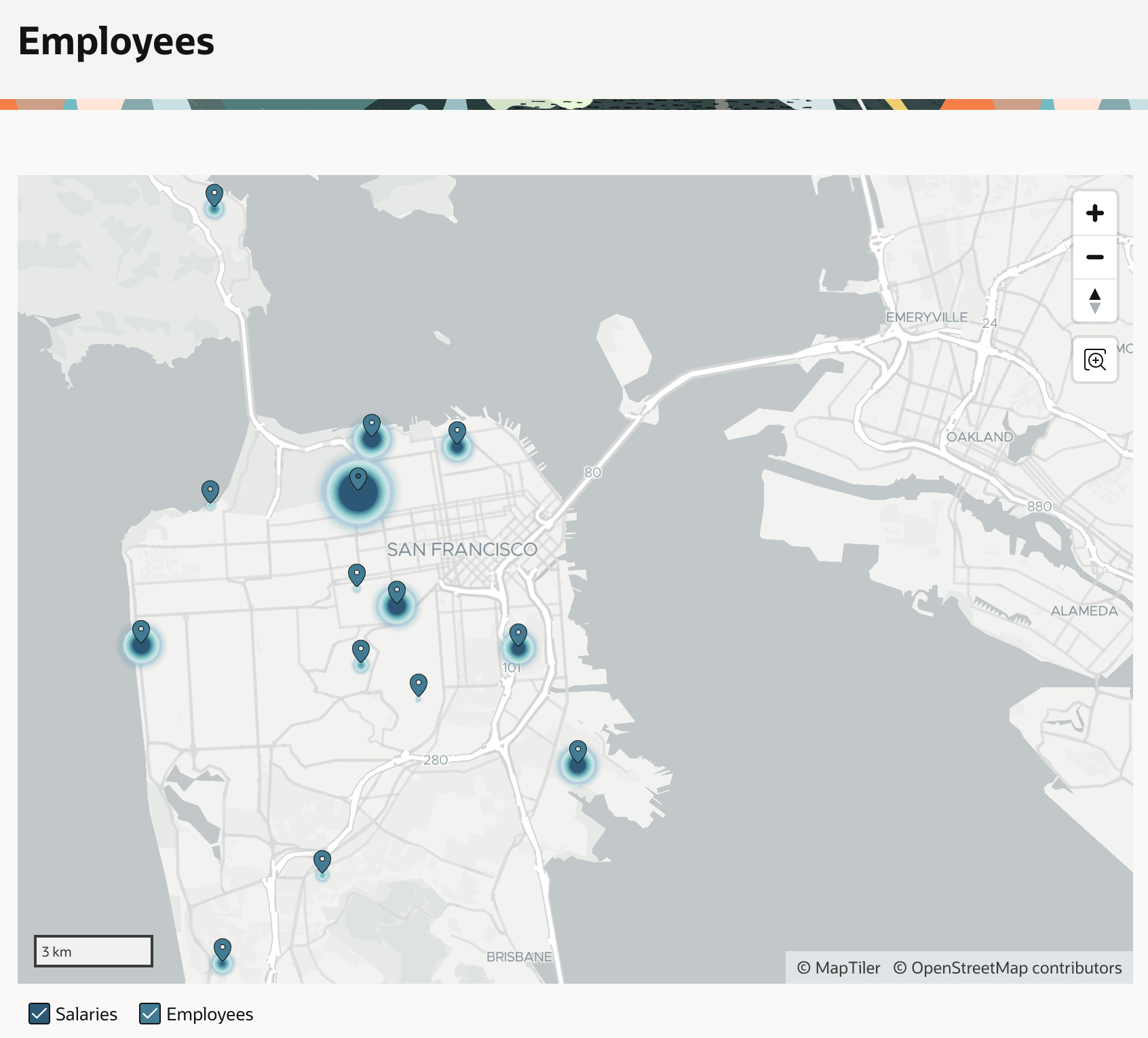

A Heat Map layer associates an additional quantity to a point to convey how that value differs at different points on the map.
After adding an additional Salaries heat map layer, using
TOTAL_COMPENSATION as the value column, the page looks like the
figure below when both layers are displayed. Each employee's address marker now shows a
circle sized proportionally to their total pay relative to their peers.
Figure 5-13 Point Layer and Heat Map Layer on a Map
