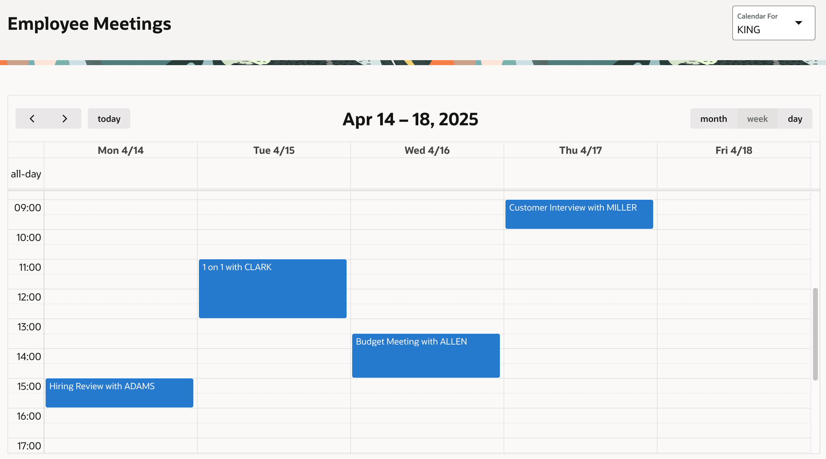

To show additional information in the calendar for each event like the name of the employee invited to the meeting, you could create an EMP_MEETINGS_V view to join the EMP_MEETINGS table with EMP to retrieve the inviting employee name and the invited employee name like this:

You could then change the region to be based on the SQL Query below that selects from this new view. It uses a CASE expression as part of a FORMATTED_TITLE column to show either the MEET_WITH_ENAME or the CALENDAR_FOR_ENAME value, depending on the value of the P19_CALENDAR_FOR page item.

After changing the event title to use the new FORMATTED_TITLE column, the calendar looks like the figure below showing the name of the person KING is meeting with.
Figure 5-18 Events Showing Purpose and Meeting With Employee Name
