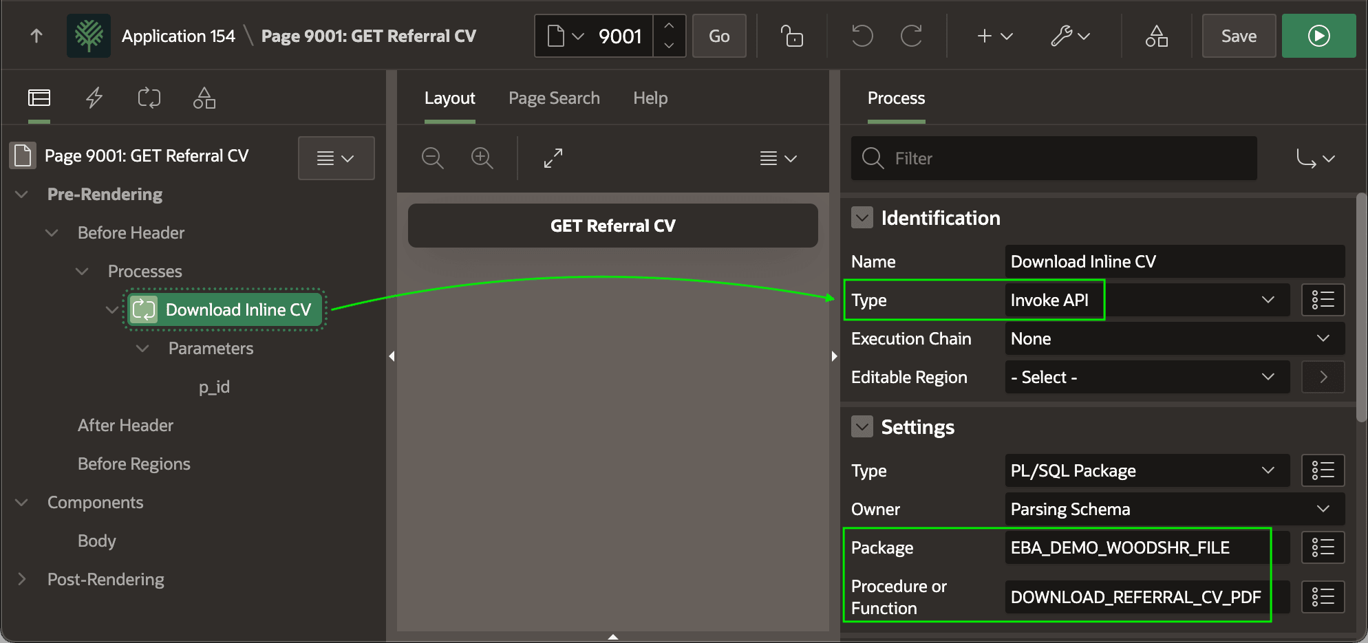

Call this procedure with an Invoke API process in the Before Header section as shown below. The figure shows the Download Inline CV page process and highlights its Type of Invoke API, Package name of EBA_DEMO_WOODSHR_FILE, and procedure name of DOWNLOAD_REFERRAL_CV_PDF.
Figure 16-60 Pre-Rendering Invoke API Process to Download a PDF

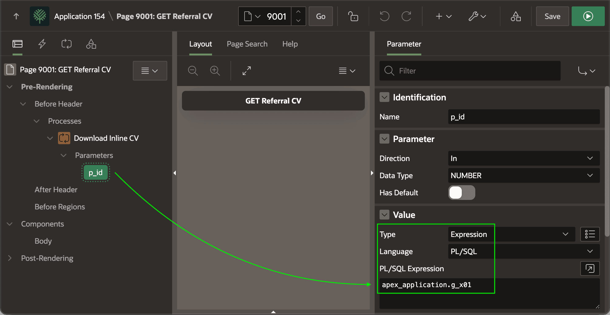

Configure the value of its p_id parameter using the PL/SQL expression apex_application.g_x01 as shown below.
Caution:
If any authenticated user can view any PDF, as in this Woods HR example, using the convenient X01 parameter is fine. However, to guarantee a generated URL referencing a particular PDF BLOB file cannot be manipulated to view a different one, use a checksum-protected hidden page item instead to pass the file ID to download.
Figure 16-61 Configuring Break Room Referral ID Parameter Value
