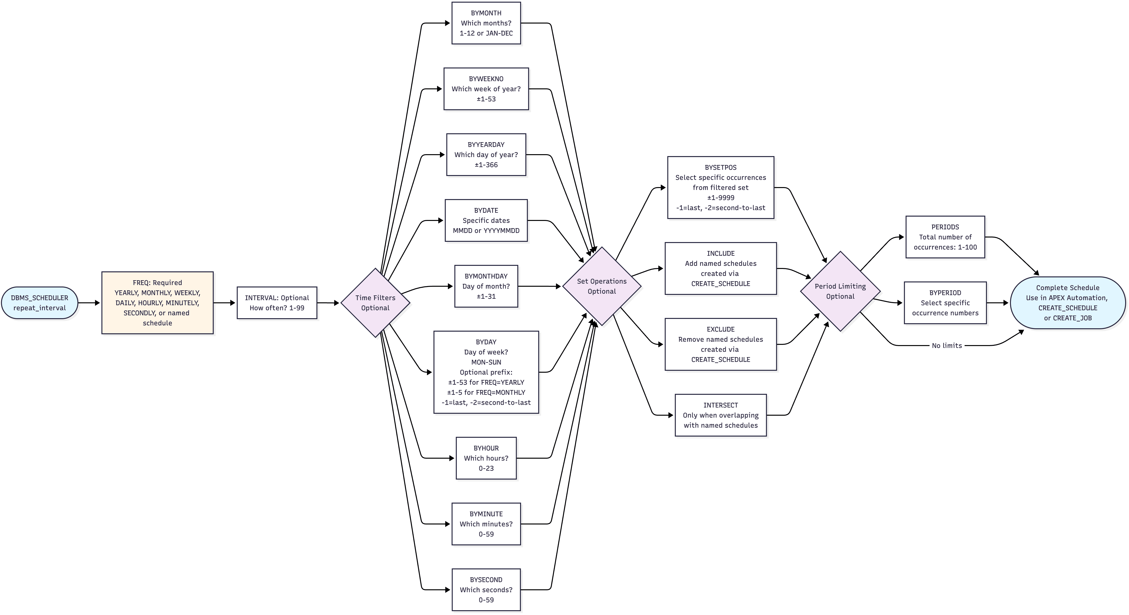

The automation's Schedule Expression supports any Database Scheduler syntax. These are the same ones the DBMS_SCHEDULER package accepts to create named schedules and create scheduled jobs. The diagram below summarizes the options you can use. You specify an expression using semicolon-separated list of one or more KEYWORD=VALUE elements. Supported keywords include:
  • FREQ – Frequency of repetition (required)
  • INTERVAL – Repetition counter (n = repeat every nth frequency unit)
  • <Time Filter> – Identifies specific time elements to fine-tune exactly when it repeats
  • <Set Operations> – Combine with a named schedule, or pick occurrences within a cycle
  • <Period Limiting> – Limit the total number of cycles, or pick specific cycle occurrences.
Figure 19-7 Syntax for DBMS_SCHEDULER Calendar Expressions
