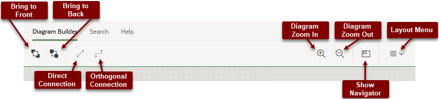

The diagram toolbar contains tools for interacting with the Diagram Builder.
The diagram toolbar at the top of the Diagram Builder contains context-sensitive tools for changing how the workflow displays on the Drawing Area in the center of the page.
Description of workflow_diagram_toolbar.png follows
Use Bring to Front and Bring to Back to move activities on the drawing area forward or backward. This can help in places where activities on the drawing area overlap.
Use Direct Connection and Orthogonal Connection to change the appearance of specific connections. Direct connections are straight lines between two activities. Orthogonal connection use a combination of vertical lines, horizontal lines, and ninety-degree angles to connect two activities.
Tip:
You can use the Default Router Setting option on the Layout Menu to set the default connection style for the workflow. Changing the default router setting does not update any connectors you have already individually configured.
Description of workflow_direct_orthogonal.png follows
Use Diagram Zoom In and Diagram Zoom Out to zoom the drawing area in and out.

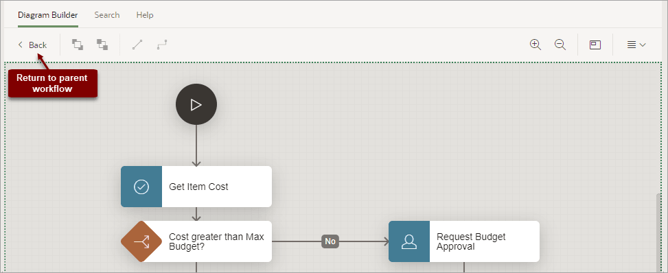

If you view a workflow invoked from another workflow, a Back option appears in the toolbar to easily navigate from the invoked workflow back to the parent workflow.
Description of workflow_diagram_back.png follows

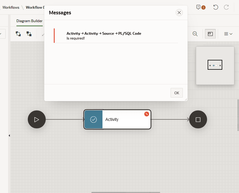

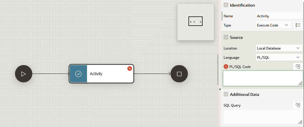

Once you drag an activity onto the drawing area, a context-sensitive icon appears in the top right corner. The icon is red when there is an error or missing information in the activity. Selecting the activity brings up the activity properties with the error location(s) marked.
Description of workflow_activity_property_error.png follows
The Show Messages icon displays the number of errors in the workflow. You can select the icon to display a list of the error messages. You can select a specific error message to bring up the activity properties.
Description of workflow_activity_error.png follows

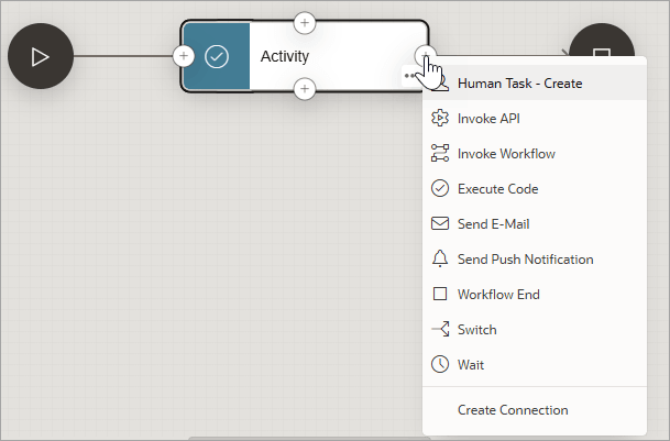

Activity Tools
Activities show two kinds of tools: the Connect tool and the Menu tool. These tools are context-sensitive, and are not visible if they are not available. For example, an end activity does not show the Connect tool, because end activities cannot have outbound connections.
Use the Connect tool when connecting two activities. The connect tool is available on multiple sides (top, right, bottom, or left) of each activity. Clicking the tool opens a menu where you can select the type of activity. APEX creates the new activity on the same side you clicked the connect tool on.
Description of workflow_activity_connect_menu.png follows
You can also use the Connect tool to create a new connection. Drag the end of the connection over an existing activity to connect it, or drag out from the connection tool on the existing activity to draw a new connection.
Description of workflow_new_connection_no_end.png follows
Use the Menu button to open a menu with the available actions for the activity.

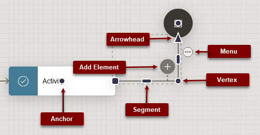

Connection Tools
Connections may show different types of tools depending on which conditions they meet and whether they use normal or orthogonal routers:
  • Arrowhead - Appears at the end of the visible connection at the connection point with the activity. At the source activity, it is a rounded rectangle. At the target, it is a triangle. Use arrowheads to reposition the ends of the connection. If you drag and release the arrowhead over an activity, the point where you release it is the anchor. You can drag an arrowhead to a new activity.
  • Menu - Opens a menu with available actions for the connection.
  • Add Element - Appears near the center of the connection or at the end of a connection not attached to an activity. Clicking the tool opens a menu with activities to place at the mid-point of the connection, effectively splitting it in two, or at the end of the connection.
  • Vertex - Appears as point(s) on a connection. Connections always route through their vertices. Drag the center of a link to create a new vertex. Double-click an existing vertex to remove it. Drag an existing vertex to reposition it.
  • Anchor - Appears over the source or target activity when a link is connected to it. Reposition anchors by dragging the circle or releasing the arrowhead over an activity. Double-clicking the anchor sets the anchor position to the center of the activity.
  • Segment - Appears between two horizontally- or vertically-aligned connection points. Drag a segment to move that segment horizontally or vertically. This may create new vertices.
Description of workflow_labelled_connection.png follows
