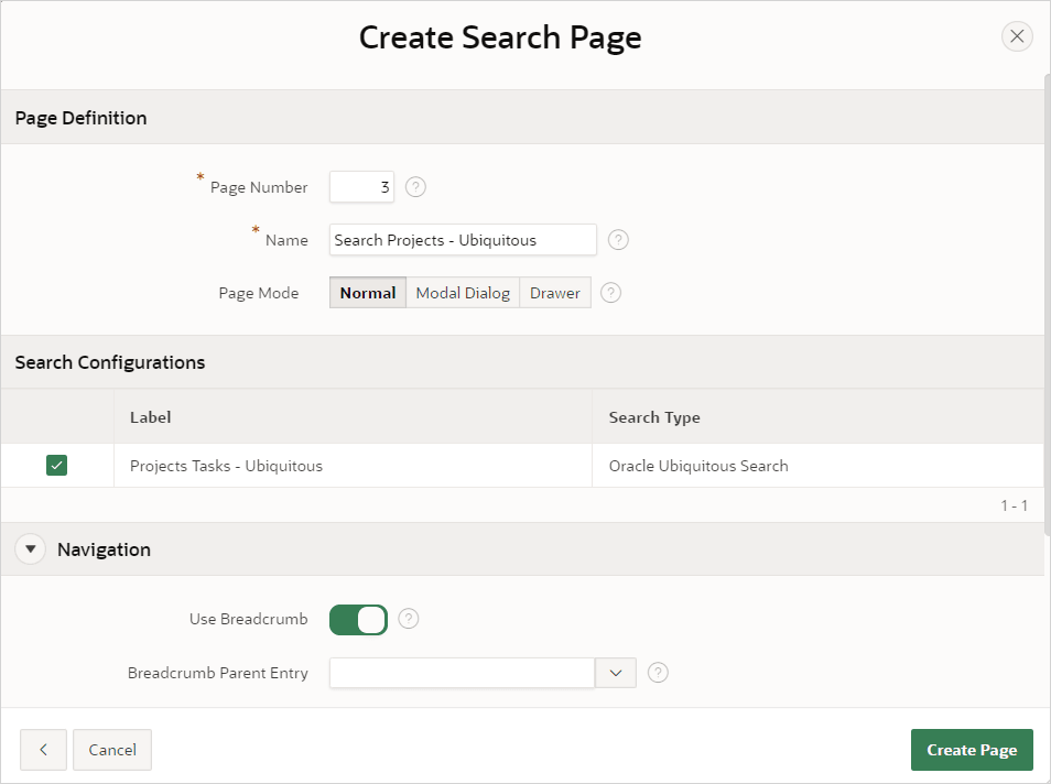

To create a search page by running the Create Page Wizard:
  1. Navigate to the Application home page:
    1. On the Workspace home page, click the App Builder icon.
    2. Select the application.
  2. Click Create Page.
    Create a Page appears.
  3. Click Component and select Search Page.
  4. Page Definition:
    1. Page Number - The page number is an integer value that identifies a page within an application.
    2. Name - Specify a text name for this page (for example, Search Projects - Ubiquitous).
      This text is also used for page Title. After page creation, you can modify the Title in Page Designer.
    3. Page Mode - Identify the page mode. Accept the default, Normal.
  5. Search Configurations - Select the search configuration to be used by this page (for example, select Projects Tasks - Ubiquitous).
  6. Navigation - Accept the default and enable Use Breadcrumb.
  7. Click Create Page.

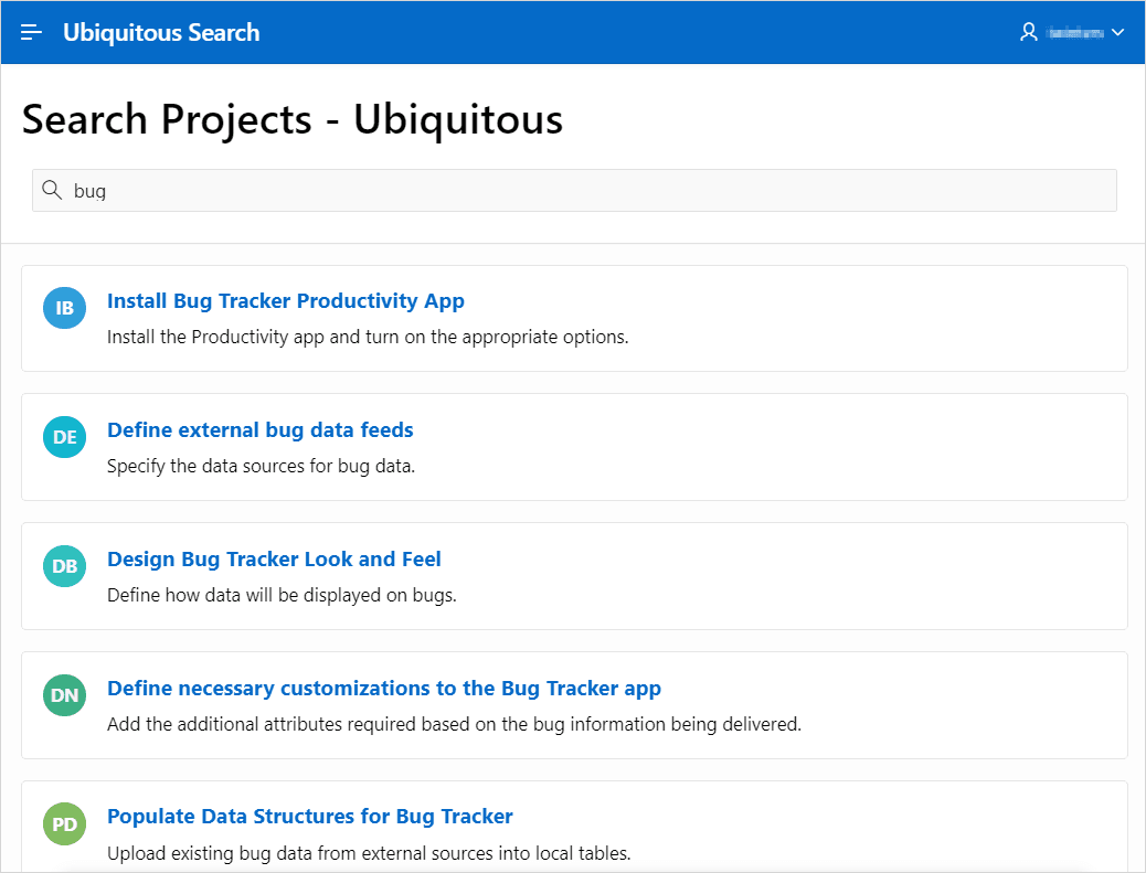

  8. Run and test the page:
    1. Click Save and Run Page.
      The search page appears.
    2. In the search field, enter a search (for example, bug) and press Enter.
